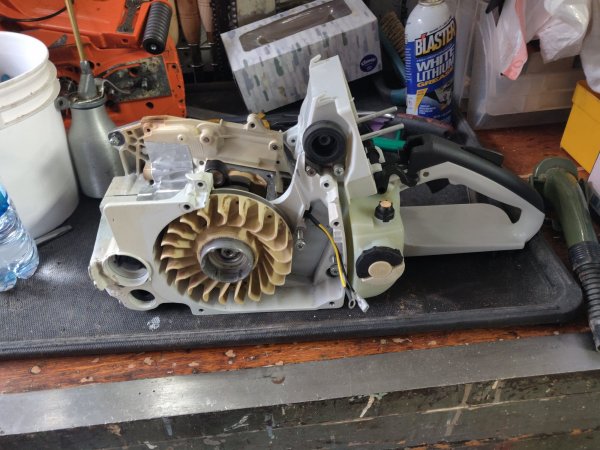

    Oooooo baby we are making some progress. Actually it took like 2 minutes to do this as I'm still waiting for the piston and cylinder to arrive.....
    But I was busy cleaning up the garage and figured I'd do something to do with a chainsaw as it has been raining all day.

    You tightened and double checked the flywheel nut?
  14. LordOfTheFlies
    LordOfTheFlies
    Apr 5, 2019
    2,519
    12,101
    NY
    I never took it off!

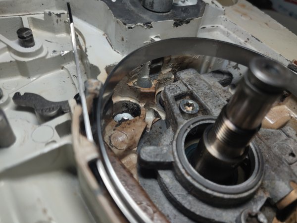

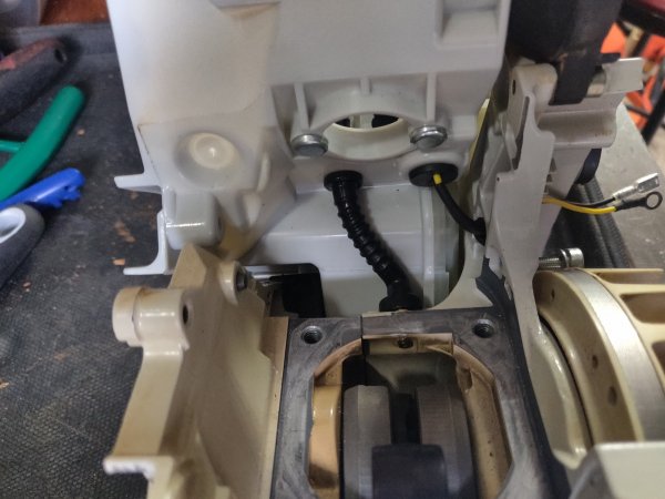

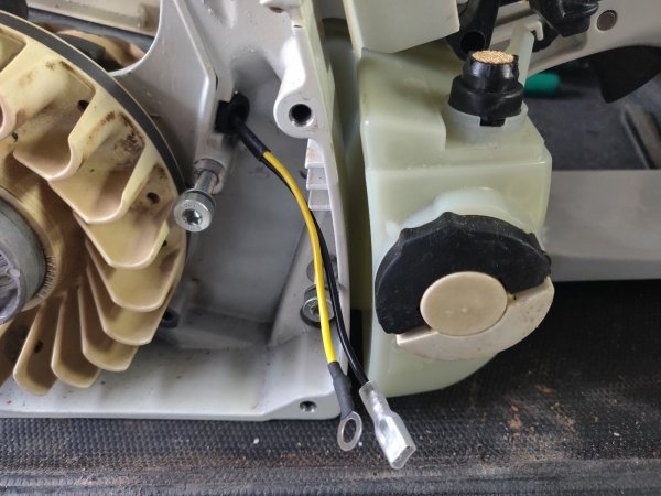

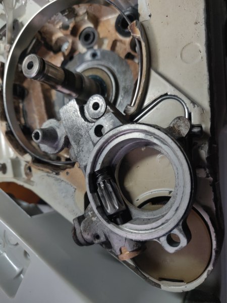

    PSA this little rubber grommet goes on the oil pump. I noticed there was a gap there and looked up the parts diagram. Phew. Disaster averted.
    Also the ground wire just goes in between the right coil screw and the crankcase.
    My before pics sucked because the saw was just caked with muck.

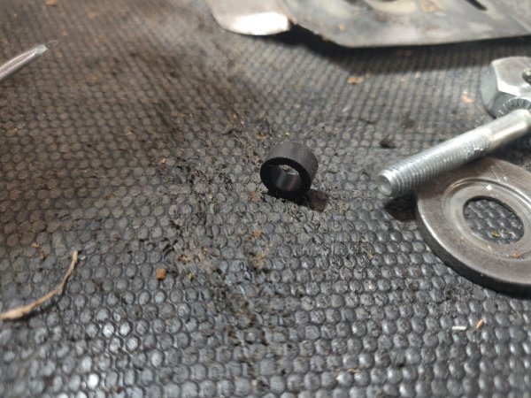

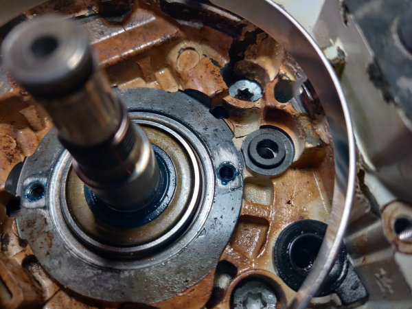

  19. LordOfTheFlies
    LordOfTheFlies
    Apr 5, 2019
    2,519
    12,101
    NY
    Ok got that rubber seal in there.

  20. Cold Trigger Finger
    Cold Trigger Finger
    Oct 4, 2017
    2,866
    17,366
    Easern Central Alaska
    Ya, That would have been a Mess !!
