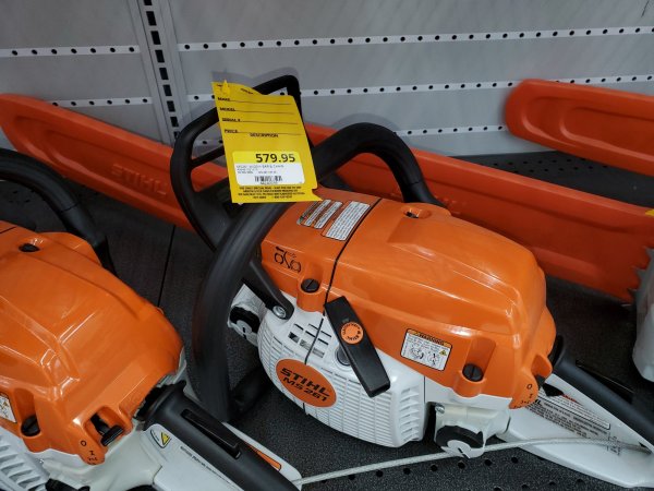

    I didn't make it by the Stihl dealer mentioned above but I stopped by Rural King today to see about some vole bait when I noticed a big Stihl logo on the outside of the building. So I went in and sure enough, they have Stihl products. They had two 261 in stock; one with an 18 inch bar and one with a 20 inch bar; the 18 inch bar was $20.00 cheaper or so. They also had a 271. I was watching a video last night and they mentioned the 271 had a polymer casing; what is that exactly? The 271 is a 1/2 HP lower; how significant is that? The other thing is the electronic control for the fuel mixture; should I look at that option or go without? They had a saw with the electronic control but neither of the 261 had it (the c notation). This may just end up being my Christmas present this year; a little more than I usually spend on myself. Rural King use to do a 10% off everything on Black Friday. Here are some photos, as you say, photos or it didn't happen :D Notice how they have all the saws cabled in place. Maybe they are afraid someone will grab some premix fuel off the shelf and go on a chainsaw rampage through the place.

    271 is in the farm/ranch level and not a bad saw for general firewood cutting IMO. The 291 is what the 290 evolved into.
    271 is 50cc's, 291 is 55.5cc's. Both weigh the same.
    I replaced my 290 with a 261 which is a pro model saw.
    Saws chained together for theft. Smart on their part. None of my OPE dealers do that. Ive seen tools stolen from Lowes while im there.

    261
    726
    Maine
    The 261 will be the last saw u ever need/buy. It’s worth the coin all day long. I have a 260 and 361 and my 260 gets used 99% of the time. It’s light and has all the power u need for most jobs with an 18” bar.

    I don't think I've ever met an unhappy MS261 owner. Myself included. As far as the C-M (electronic fuel adjustment) option goes, I favor it. But you should go in knowing that should that system ever need diagnostics/service, you'd likely not be able to do the work yourself as a dealer diagnostic tool is required. I'm good with that, and I've experienced no failures on either of my C-M saws to date.
