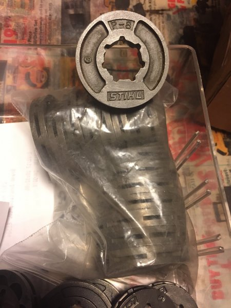

  14. P8 are about a thing of the past/unless you know someone that has some?
    I am hoarding just a few of them :)
