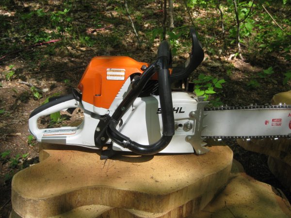

    My 400 came with a full wrap (the guy i bought it from tricked it out) My only full wrap saw. IMG_1073.JPG

    So he bought the 250$ 362 wrap kit

    Here's the thread. Got the saw with bling for $850 and it looked BARELY used.
