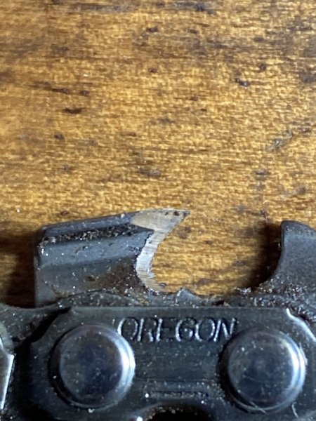

    I’ve seen people round grind like this multiple times. I have 2 loops like this:
    3C9E2CE1-C27F-4F8B-A6C9-F6585484A619.jpeg AB732E9A-409B-4C16-BE83-F45A426E882C.jpeg
    Guess it’s kill 2 birds with one stone (pun intended). Keepin’ those gullets clear, lol.

    Get the gullet, Billy

    I typically go Almost all the way in myself but the little bump in the gullet has to go.

    :rofl: :lol: Oh he got it ahright! This stuff is grabby as heck.

    So almost no round sideplate?

    Maybe I'm missing something in looking at the pictures. The angle in the pics looks a bit severe.
    I just meant I go in pretty much to the bottom of the gullet. Keeping the stopping point the same with no bumps.
    I prefer some extra room to reduce recutting of the chip.
    What angle, head tilt wise is the pictured chain ground at ?

    No idea, I don’t have a round grinder. What I see is the entire sideplate is straight, like these hexa-files are doing.

    No there talking about that tiny bump that was left from the factory grind on the bottom where is hits the actual chain links. The little piece of metal bumped up , the file goes in behind it at this point. Should of taken it out when first starting to file that specific chain

    I was referring to how far the round shaped wheel is being taken down in the cutter when grinding. If it's pushed far enough, like the pic I posted, none of the round profile is left on the cutters side plate. This essentially crates the straight profile that the hexa is leaving, although with a grinder there is much more of it.
