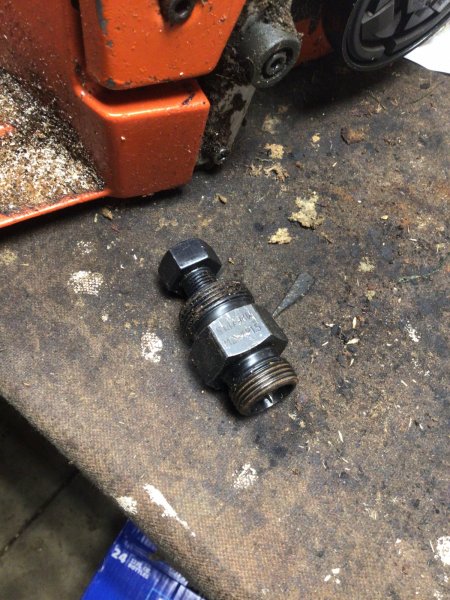

    I use this on Stihl’s
    It’s been bullet proof and if it starts to wear out, I’ll spend another $11 to get another.
    edit
    Went and looked at what it actually looks like. This thread talks about another method that works too
    Removing a Stihl BG86 blower flywheel

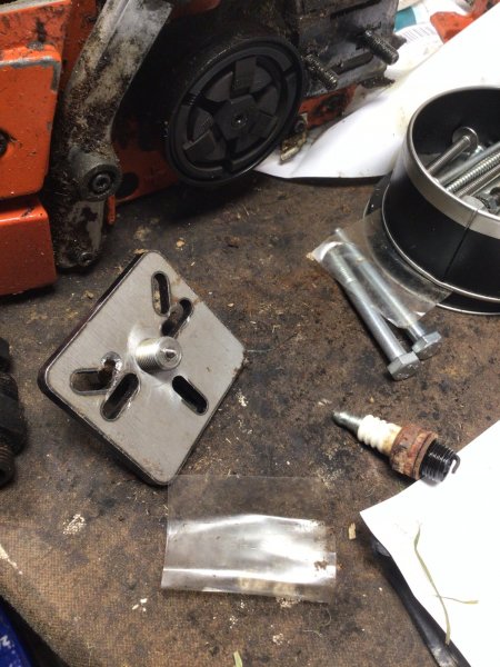

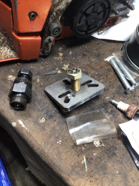

    i do have a puller for Husqvarna that sounds like what you need if the dead blow method doesn’t work. I think I found this looking for a puller for a 2100CD.
    13DC1A30-C7FD-495F-B8B9-BD85A16E666A.jpeg CC806A38-321C-4C3C-8895-DA1B0B2E1B8E.jpeg

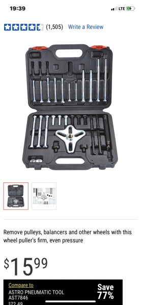

    That looks like what I"m looking for. Would you happen to have a part # for that one.
    M2theB likes this.
  7. rusty ranger 44
    rusty ranger 44
    Feb 21, 2020
    279
    1,613
    south central Pa
    I don't think that one will work. The center yoke looks to be too big for this flywheel.

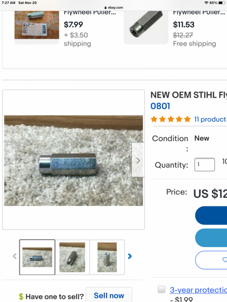

    I have pulled flywheels off of all kinds of small motors and have never used a puller. I have always used a hammer, a small round piece of steel that will sit on top of the end of the crankshaft and a pry bar. I have used this method on lawn mowers, string trimmers, blowers. ice augers, and all kinds of chainsaws.
    When you tap on the end of the crankshaft it will cause a vibration that will eventually cause the flywheel to come loose and with a little pressure from a pry bar it will lift up.
    I have never distorted any threads because I use the flywheel nut and put it even with the end of the crankshaft end. I have never broken any parts with this method.
    I am not hitting directly on the end of the crankshaft because that is where the small round piece of steel it sitting.
    M2theB likes this.
  9. M2theB
    M2theB
    Jan 13, 2017
    2,989
    19,074
    Central Massachusetts
    looks the piece / part you mention above is a long nut, so you can do what Mag Craft is describing.

    Could drill some holes in a piece of flat stock and use a nut and bolt?
    MAF143 and M2theB like this.

    Thats what I have done, but the long hex knocker that threads onto the crank is what I use mostly.
    M2theB likes this.
