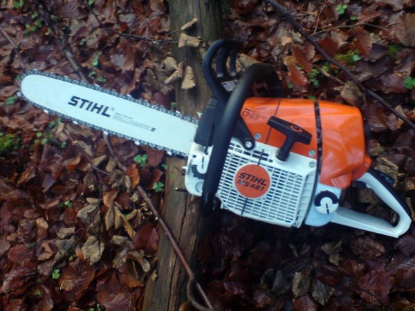

    Got this pic off google but thats her with 20" E bar I believe, maybe shorter..idk. This Friday the 461 w/20" ES bar RS full chisel at my dealer is coming home:dex::dex:

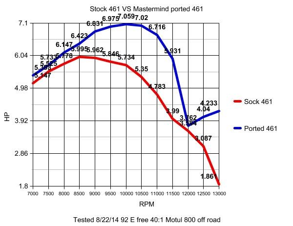

    The 461 is no doubt worth modding. On dyno it will add about 1.9hp over stock at 10500rpm

    Mine responded very well in stock form with a mm and dp cover, poly flywheel, advanced timing, 460 coil, and carb limit trimmed

    The lean on torque is very apparent after porting though. Well worth the investment
