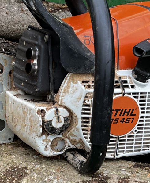

    If you notice that the pic of the muffler on the MS460 I showed has two ports and both have screens in them. But twice the opening means twice the screen area too.
    You do not have to keep the screens in unless you are cutting on National Forest which I do a lot.
    I would never cut on National Forest without a legal spark arrestor. For one the fines and then you would probably lose your wood cutting privilege.

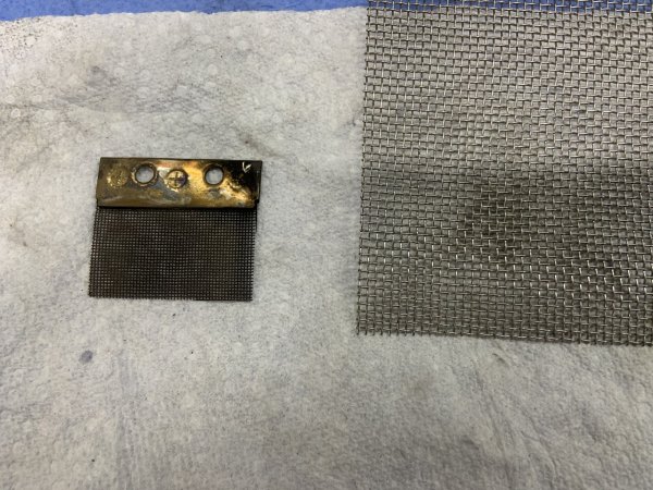

    A5642057-C804-43E7-A703-1DBF2534FBE5.jpeg I got this a few years ago. Game changer!!!it was some after market guy that has since failed.
