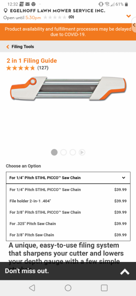

    But what many are needing to know is about buying a Stihl 2 in 1 Sharpner, i understand the need to know the right file sizes needed as to the chain you are wanting to sharpen.
    After doing some searching i found the imformation needed on the Stihl web site.
    There is also a dropdown on Stihls web site for the 2 and 1 that tells you what units file sizes are needed and the right 2 in 1 sharpner needed.
