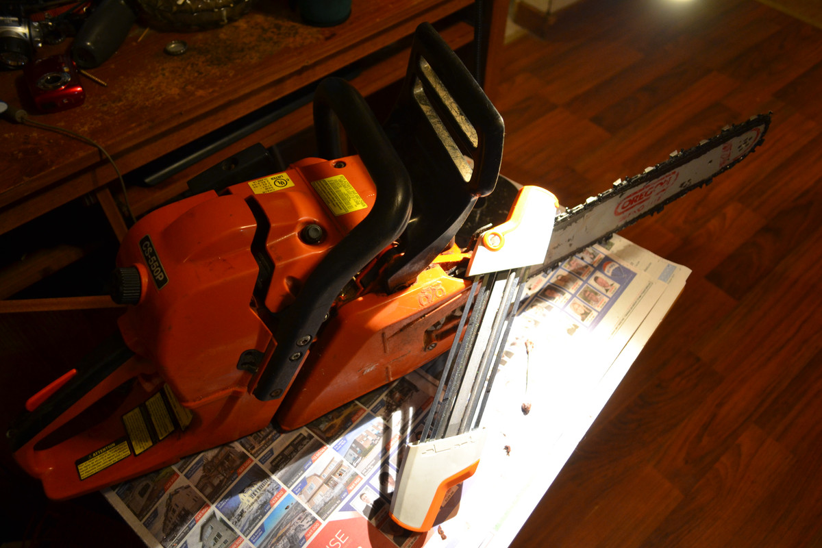

  15. Loon
    Loon
    6,560
    37,138
    North of the border
    I like it very much but after a few sharpes i tend to push down with forefinger on the raker file.
    Horkn and metalcuttr like this.

    Is that a Stihl PM3 chain in picture?
    Horkn, metalcuttr and Loon like this.

  18. Loon
    Loon
    6,560
    37,138
    North of the border
    Oregon.:salute:
