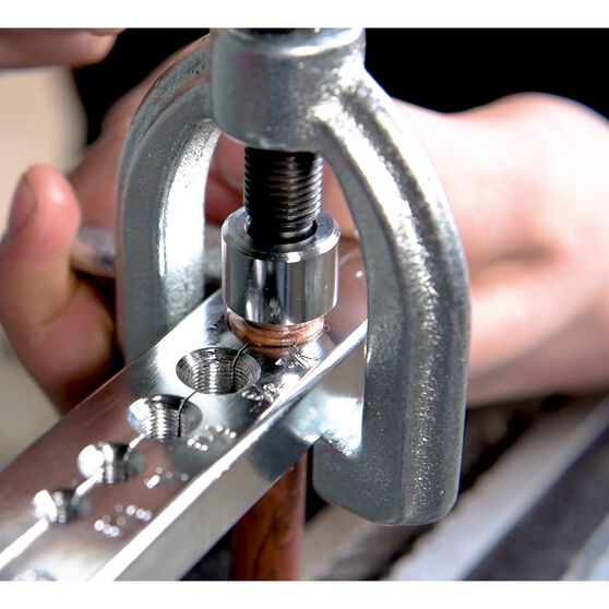

    I just restored a puller of some sorts. I don't know if it will fit the race. The arms are quite wide and thick. I just checked and it was too short and the legs aren't quite right.

    That "puller" is part of a tubing flaring tool kit.

    Thanks. That must be for 3/4" or larger pipe because the jaws are big.

    No, 1/2" and down...there are other pieces to it.
