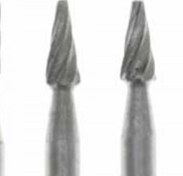

    The muffler is off the saw now so this would be the time to do it. Do you mean a cone shaped burr like in the attached? And just bore out the existing holes? 2016-09-09 23.40.33.png

  5. MasterMech
    9,648
    26,037
    Greenville County SC
    Does your muffler have four tic-tac holes in the front or two? If you already have four, you can drill a 5/16"-3/8" hole in the dimple and focus on enlarging the opening in the deflector as it is the biggest restriction.
    If you have two, just make two more ovals on the opposite side of the dimple and drill your hole in the dimple. Then the deflector work.
    The dimpled area is inside of the internal baffle, while the narrow border around it where the oval holes are is outside of it. Holes made inside the dimpled area will make a big difference in both power and noise.
    You will definitely need to re-tune the carb after all this.

    What MasterMech said and yes those burrs in the picture will work.

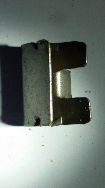

    20160918_162205.jpg 20160918_162339.jpg Parts have arrived so time to reassemble. I found a clip like thing that I have no recollection of removing. Photos attached. Anyone know what this is and where it goes? Thanks again
