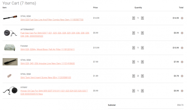

  3. LordOfTheFlies

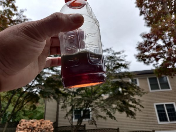

    1. First I drained the fuel. In hindsight I should not have tried to start it the other day but what's done is done. The fuel stank and smelled like varnish.

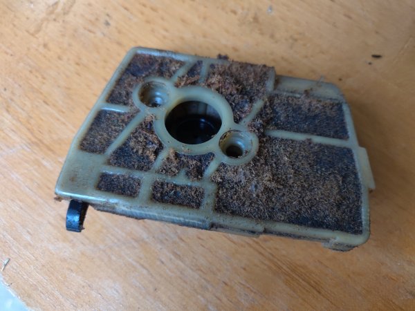

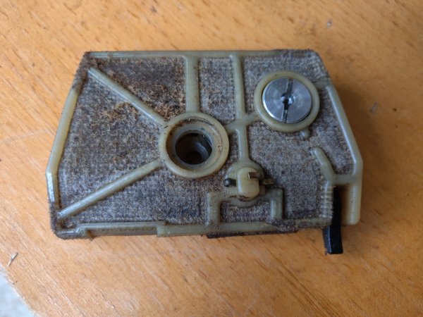

    2. I took off the cover and saw the air filter was pretty dirty. I'll probably clean it off and purchase a new one anyways.

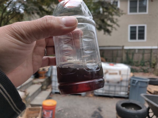

    3. Drained the bar oil. It looked ok.

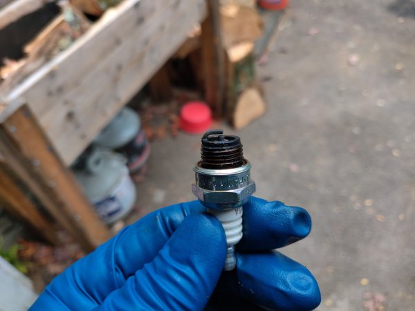

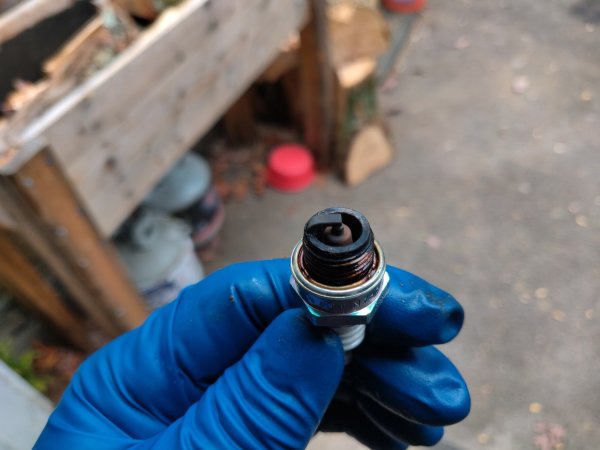

    4. Removed the spark plug. Looks like I should put a new one in.

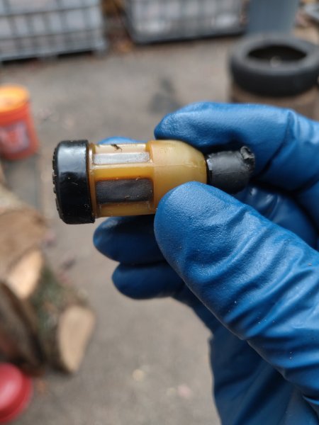

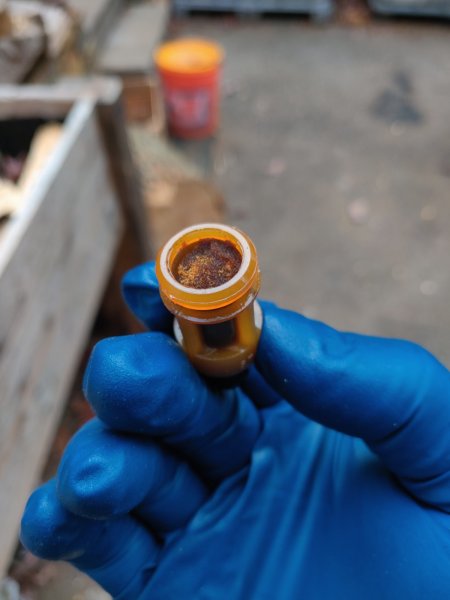

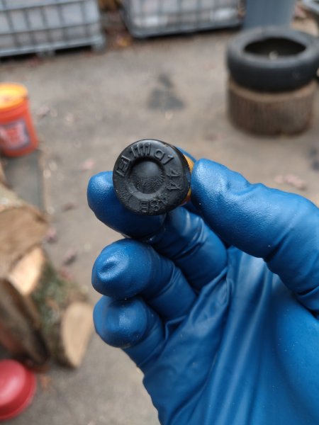

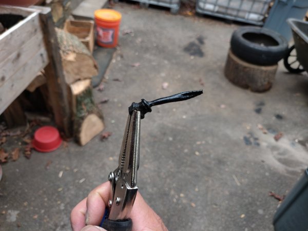

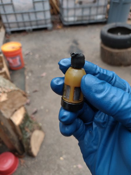

    5. When I removed the fuel tank I noticed the fuel filter was separated from the hose. It was in bad shape and FULL of nastiness. I need a new fuel line and a fuel filter. The old hose literally just melted where it broke - so part of the hose on the fuel filter itself is just closed up and so is the other side of the hose.
    2020-10-25 15.04.20.jpg 2020-10-25 15.04.25.jpg 2020-10-25 15.04.29.jpg 2020-10-25 15.04.31.jpg 2020-10-25 15.04.54.jpg 2020-10-25 15.05.07.jpg 2020-10-25 15.28.13.jpg 2020-10-25 15.28.28.jpg

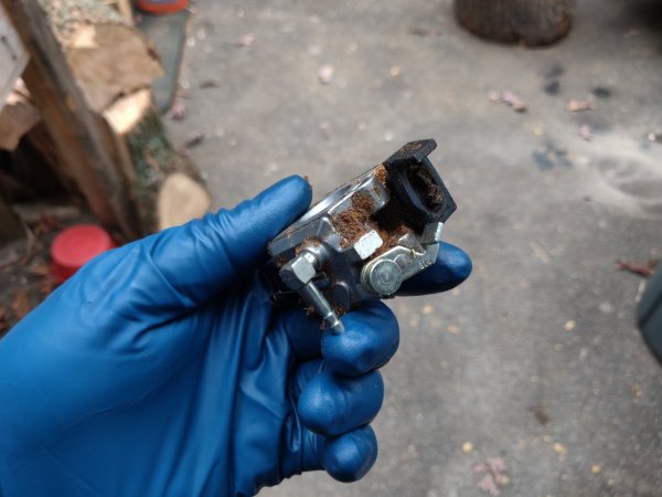

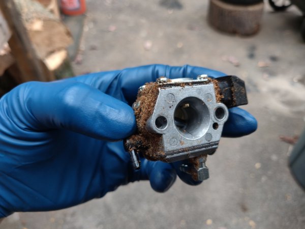

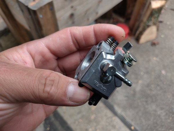

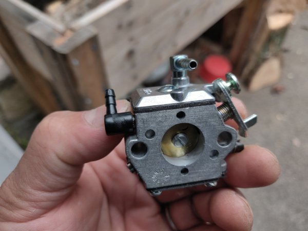

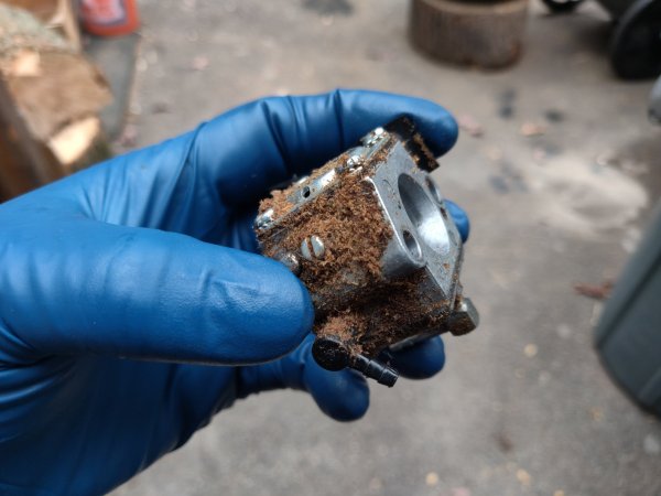

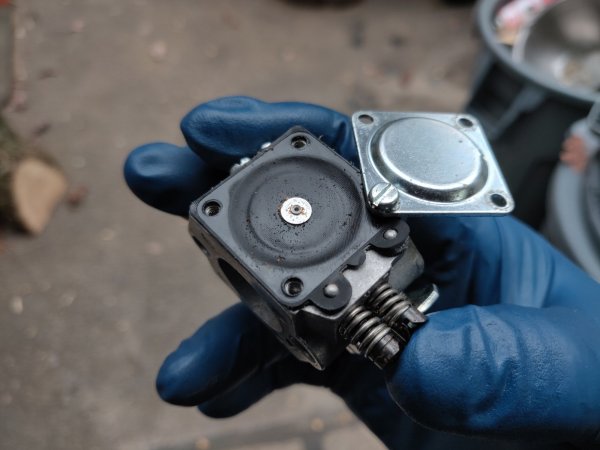

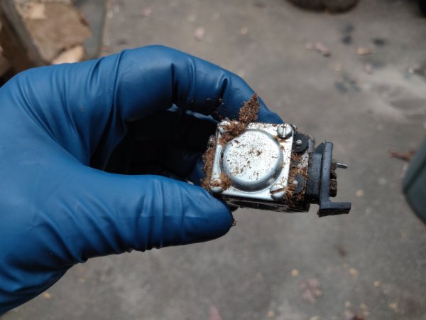

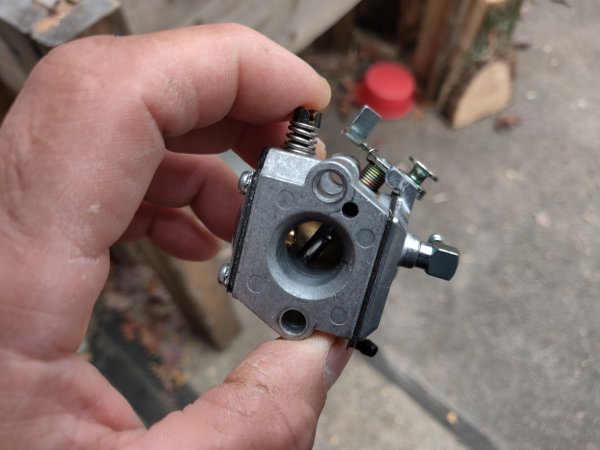

    6. Removed the carburetor and looked at one of the gaskets. Besides a little bit of grime it felt fine. I may be able to get away without putting in a new carb but if it's $20 I'll buy a new one. It's a Walbro.
    2020-10-25 15.15.57.jpg 2020-10-25 15.15.59.jpg 2020-10-25 15.16.01.jpg 2020-10-25 15.16.03.jpg 2020-10-25 15.22.03.jpg 2020-10-25 15.25.14.jpg 2020-10-25 15.25.20.jpg 2020-10-25 15.25.23.jpg 2020-10-25 15.25.26.jpg 2020-10-25 15.25.27.jpg

    So yeah, I need a rebuild kit - carb, fuel line (oem as I did not like the crappy line included in the video above), spark plug, carb cleaner, air filter, and might as well put a new oil cap and gas cap while I'm at it. Then I'll try to start it.

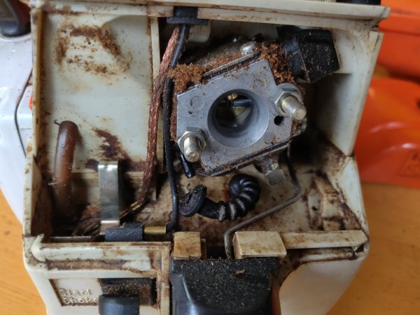

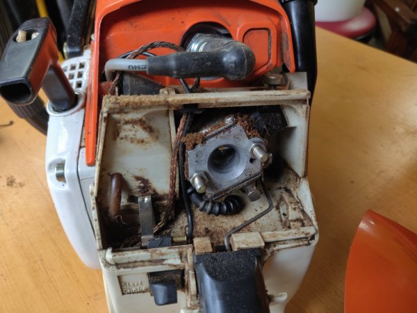

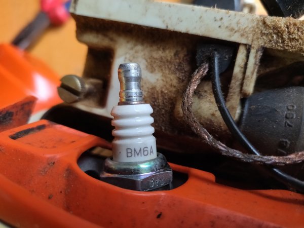

    Is the impulse line the black rubber one to the bottom right of the carb in this pic? And what's that brown line all the way to the left?

    Yes. The impulse line enters the carb box there and attaches to a nipple at the base of the cylinder. They’re prone to cracking.
    The brown line is a tank vent. Watch for leaks there. Feel the line between your fingers to see if it’s shot. It should have a couple small grub screws in it.
    028s aren’t high rpm or particularly torque-y saws. The choke flap and oil system is not how I would design them, but they work. The NLA parts are annoying and some parts like certain mufflers are tough to get. Having said that (David, Larry), they can cut a lot of wood.

    How does this look?
