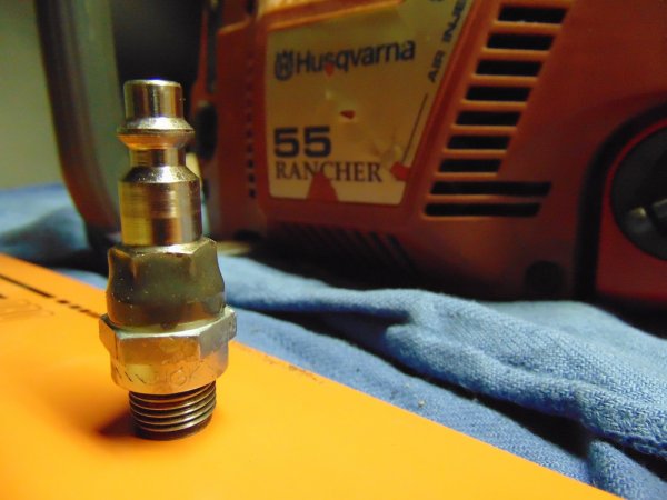

    One way I check for air leaks, take an old inner tube and cut pieces of rubber big enough to block behind the carb and behind the muffler. Then I converted an air hose nipple and an old broken plug. Apply some(light) pressure and spray soapy water, look for bubbles (make sure the piston is below ports).
