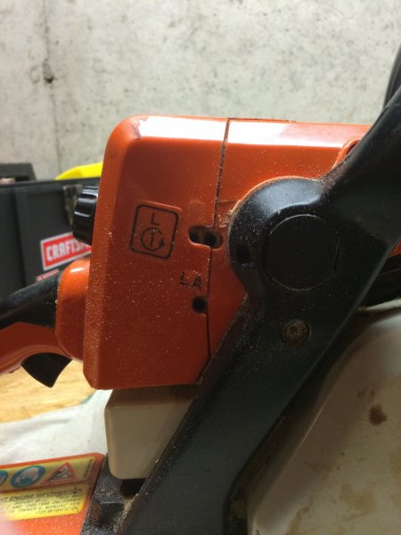

    Excuse my ignorance guys but I only see 2 adjustment screws on my 021. Is this correct? How do you go about tuning this saw with just 2 screws? Thanks.

    Should have 3? I don't think that carb was one without an H screw like the 170/180?
    Pull all the covers off and look and if you still can't see it post a pic.

    When the cover is removed there are 3 screws

    I will post a pic when I get home but the cover only shows 2 holes: L screw and LA screw.

    They must not want you messing with H so they didn't put a hole in cover.
    I have found that if you can find a china replacement carb on ebay they usually all are adjustable where the originals werent

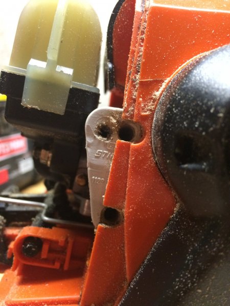

    So once the cover is off can you get your screwdriver on a screw head to turn or is there a blank there like someone was talking about?

    it seems like that top left hole is the H adjustment. I can fit a small screwdriver in there. It feels like you can turn it in and out.

    Well if you can then there is a jet there I would assume? Is there a rubber boot behind the plastic flange between it and the carb? If you can pull that off you can see if there is a screw or shine a bright light into the hole. Or blow out the hole with air and clean it up good and try to back the screw out all the way and pull it out.
    Or just take two minutes and pull the carb off.

    Well I was able to adjust the H screw. I think I was able to adjust it correctly. I feel the saw was running lean before I adjusted it. My biggest fear with tuning saws is having them run too lean then burning the cylinder up. Any suggestions?

    Have it make that distinct four stroking sound when you hold it wide open out of the wood. Then clean up when pit into the wood. Too lean the saw will sound like a crotch rocket motor cycle when you do this. And too rich it will run really slow and sound like crap.

    As long as it four strokes after it revs all the way up when holding it wide open its right and you won't burn up the cylinder from that.

    Looks like the shop that worked on it already elongated the hole after they put the new carb on, or did you do that "
