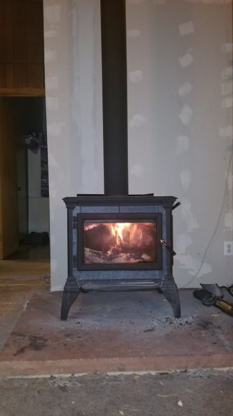

    Might be the picture somewhat. Avalon Rainier by Travis Industries. My favorite wood stove because the air control is very good. Probably many others out there as well. But I would buy this Stove again. It does have a nice glass!

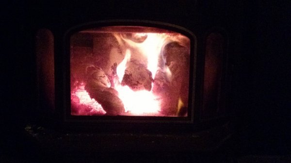

    Then I put the quadrafire 4100 insert with a bay window in it. Huge difference. The house is at 70. The furnace is not going to kick in at all for a while.

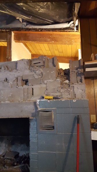

    The fireplace in the house we bought HAD a heatilator also. You can see the upper vent in this photo. It would warm the bathroom if you fed it a couple trees per hour.
    We made it a bit more "efficient".
