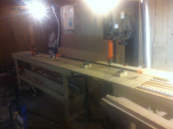

    I also built an 8' sliding table system for my vertical bandsaw, where I saw most of my lumber to final dimensions. So mostly what I'm trying to do with the chainsaw is break the logs down or saw full width live edge slabs. I'm not losing enough in the few cuts that I'm making with the chainsaw to matter either way.
