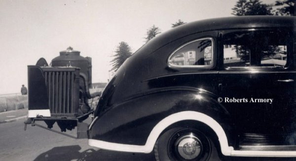

    They would burn wood or coal in the stove then pipe the stove exhaust to the carburetor to be used as fuel. The car would start on gasoline then be switched over to the wood/coal gas.
    http://en.wikipedia.org/wiki/Wood_gas

    That is very interesting! With all the driving I do I need that contraption..:rolleyes:

    On the show the Colony they made those on the 2 seasons that they made of it. Used it on a generator.

    Yes I saw that too however this looks like a more practical way to harness the power plus it looks much more refined..
