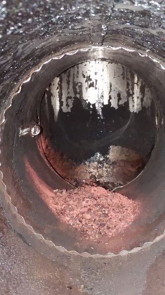

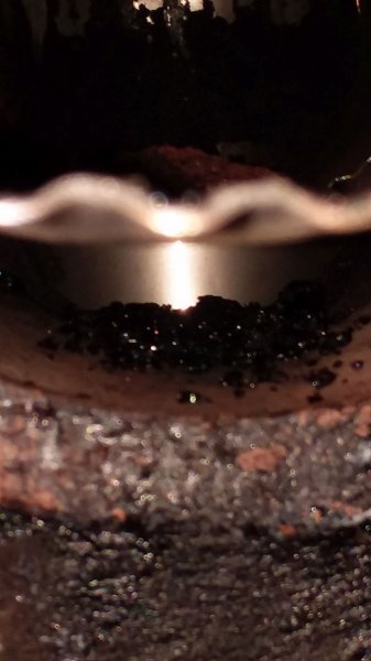

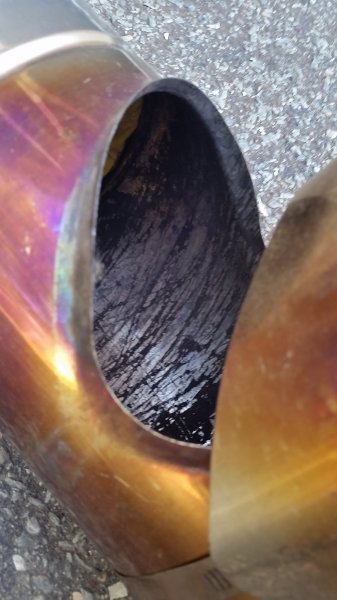

    Please read I know it's long but need your opinion. Englander nc30 installed last year in place of granny buck stove. The clay 8" was cracking in the chimney so had someone install a 6" stainless steel liner last year in July. I cleaned the chimney and stovepipes in Feb. and noticed some wet creosote under the black pipe that attaches to the stainless. This is in the 8" hole in the wall before it goes up the chimney. I thought that's weird but put it all back together. Finally took everything apart and cleaned for the winter.

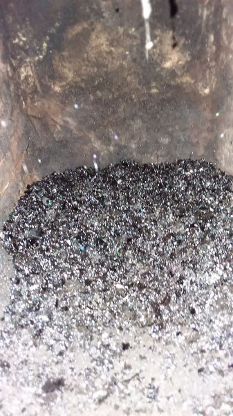

    Anything inside the stainless appears to be pretty dry creosote except for the orange color in the pic. The area under the black pipe in the wall had wet looking creosote again. They sealed the cleanout that I used before behind the stove for the buck stove. I opened it up and it's full of wet creosote. How in the world is that possible?? Yes, they cleaned out the cleanout when they installed the stainless pipe, I watched them.

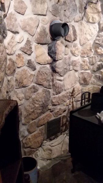

    The pipe coming through the stone there...that's not mortared in, is it?

    Could rain water be washing down the liner and be causing some of that? There is a clean area that's looks washed off in that first pic

    I wonder if they go the cap sealed up good...if not there could be rain washing down through making the black stain...doesn't explain the creosote buildup though...unless they didn't break the clay out, and there was creosote buildup on it...which is a very bad practice! But a leak up top would/could definitely wash creo off the old liner down like that...

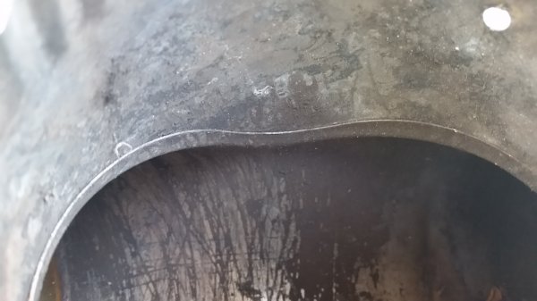

    I had a stainless t nearby for my flex liner. You can see the nice well formed lip on the vertical piece that is connected to the liner. The horizontal snout attaches to this and the band is tightened pulling both pieces together.
    Inside view of the snout with the band tightened down. It is pretty snug.
    My opinion is the vertical piece on yours looks questionable as it looks jagged. I'm thinking an air leak is letting cooler air in at the connection leading to draft issues. Insulation on the liner would have helped too.

    The pipe coming through the breech should not be mortared in...that mortar acts like a big heat sink, and that section of pipe will creosote up no matter what you do.

    I think you have a leak up top somewhere. The pipe should've been insulated either with a wrap insulation or thermix, a poured insulation. Also, a chimney sweep should be done before any liner is dropped down. Could this be last year's creosote before the liner was put in? I'm guessing at the Tee & snout, it's open to your clean out door below. Is there any sort of cap on the Tee? If so, I will suggest blocking off the clean out area with roxul tight, and having thermix poured down around the liner. Then screw that clean out door shut. Also add roxul around the pipe at the thimble area tight so no thermix comes in. Have the cap evaluated fort leaks.

    Ohhh...yeah, good thinking...that could explain the poor stove performance too!
    I have the same setup on my basement chimney...when I installed the liner I had the liner dealer crimp the bottom of the tee so that it would slip inside another section of liner, which extends down to my cleanout door. I slide a short piece of stainless pipe up into the bottom of the liner so that a cap fit on nice...once the cap is in place I slide a brick under it to hold it up in place...works great!
