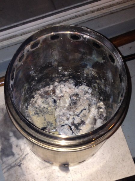

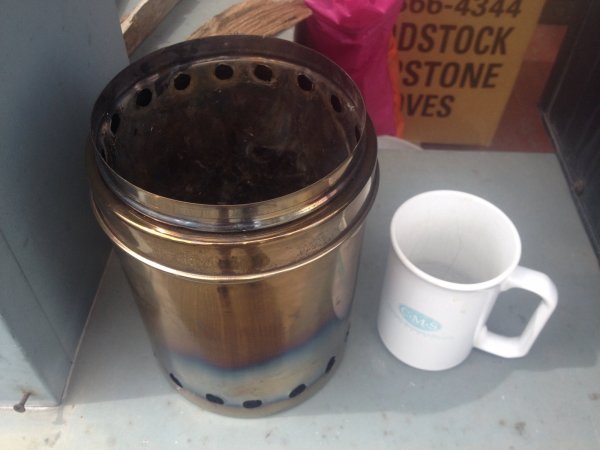

    Today I started looking around the local dollar stores and clearance/outlet stores for raw materials and found a set of five stacking stainless steel canisters with stainless lids for $20 at an Ollie's Bargain Outlet.

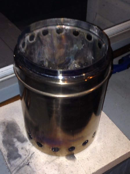

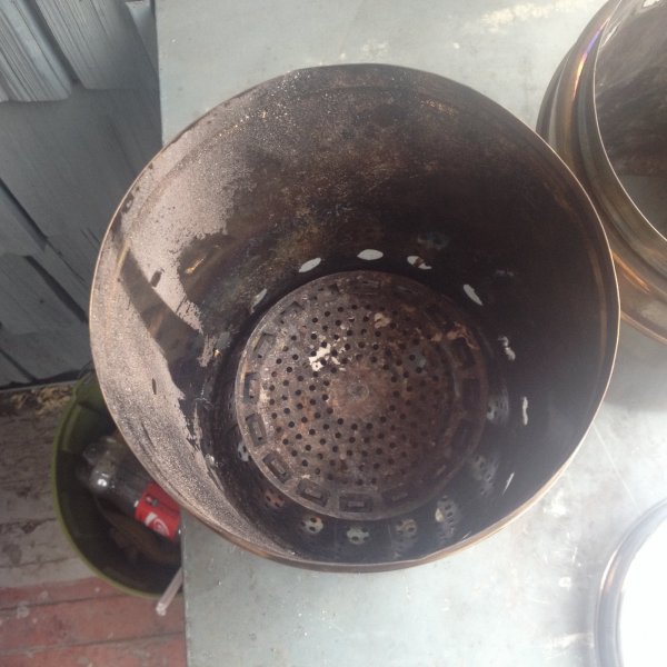

    This stove's outer canister measures approx 6 1/2" in diameter and 8 1/2" tall. I used sixteen 1/2 inch holes around the base of the outer canister and sixteen 7/16 inch holes at the top of the inner canister. I cut the base out of the inner canister with a Dremel with heavy duty cut off discs and used a perforated Sunbeam brand collapsible stainless steel vegetable steamer basket for the floor of the burn chamber. I cut the lid of the largest canister and press fit the next size canister into the lid. stainless gasifier first burn.jpg
    Here's the remaining three canisters. I'll use the next two largest canisters for a second, smaller stove (so I'll have one stove slightly larger than the original Solo stove and one slightly larger than the Solo Titan.)
    I'll use the extra lids and cut the smaller canister in half to create a pot support for each stove similar to the Solo stove design above.
    I found the Sunbeam collapsible vegetable steamer basket for $1.99:

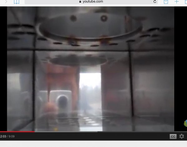

    The stove seemed to function as well as the videos of similar sized commercially manufactured gasifier stoves, with secondary air jets of flame visible throughout the burn at the top of the fire chamber. (The first video was taken right after ignition, while my 18yo and his "friend who is a girl" were hanging out with me on the porch, playing some trivia game on their smart phones, so just turn off the volume):
    I ran it for over an hour using small oak blocks, reloading every 15-20 minutes to keep a good flame going with secondary air jets.
    Next build I'll use something else than the perforated veggie steamer as the small perforations seemed to clog with ash over the course of the hour, diminishing the intensity of the burn by slowing the primary air supply. Or maybe I'll just drill out larger holes in it.
    $22 isn't bad at all for two stainless steel gasifier stoves.

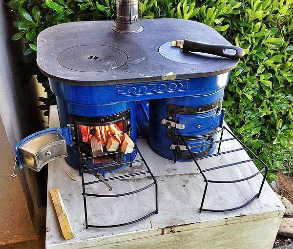

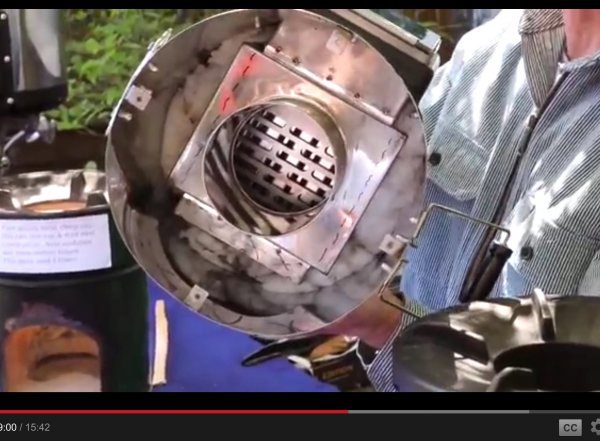

    I also have a Cabelas tent stove I picked up cheap off CL years ago that has never been used. I'm seriously considering using several of these gasifier stoves inside it as a poor man's version of the EcoZoom plancha (see photo below) that I can use indoors, vented into my masonry chimney in the basement for backup cooking duty spring/summer/fall when we're not burning our Ideal Steel stove:

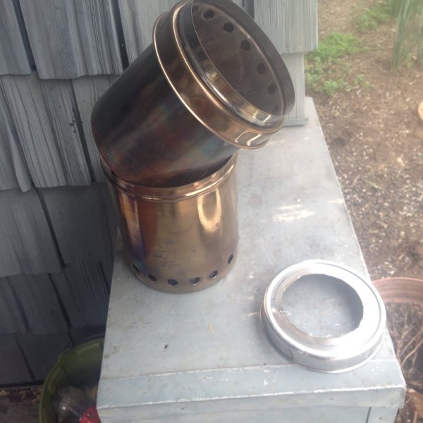

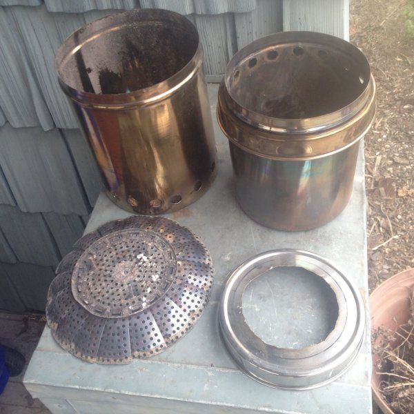

    Some daylight pics of the assembly. It all comes apart easily for cleaning and emptying ash. The last lid serves as a flame concentrator and a place for the pot support to rest.
    And burning with the pot support:
