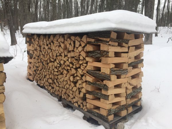

    The more you can spread out, the better for the stuff you intend to burn next year. Future years can be in wider stacks but keeping the rain and snow out will be necessary to keep it from rotting. Keep wood that was already dead separate as that will likely dry quicker. Reference the drying time chart on this website and separate by species so you can stack the quick drying species together and the ones that take longer can be in another stack.. Got any pics? That would help with evaluation.. and welcome to FHC!!! You’re going to like it here and learn a lot!!

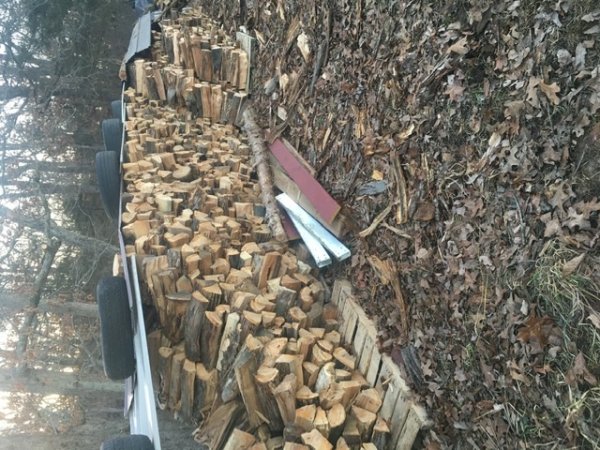

    Here’s how I stack.. Wood cut 18” long. Two rows wide and 4’ between stacks. Works out well.

    Those look like my stacks, 5 ft. high, two wide.

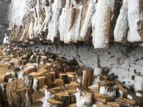

    I have never been concerned about stacking wood stacks next to each other and have never had a problem with the wood drying so long as there is a good top cover and it is not stacked tight against a building.
    I think the biggest woodpile we've had was well over 20 rows stacked tight together. One thing I do is to stack just a bit loosely rather than packing it really tight. I think it helps.
    Here are just a few.
    Christmas-2008a.JPG May 2014-e.JPG Wood-2009a.JPG Woodpile-1 2014.JPG Woodpile-2 2014.JPG

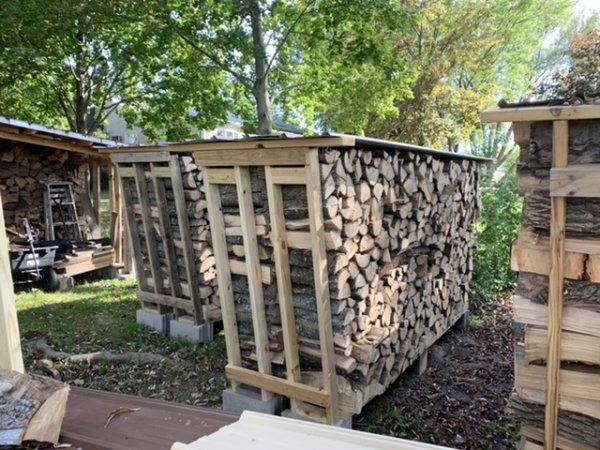

    The wood I have in stacks is two splits wide - splits are 17” long. Racks are above ground and top covered - see pics. It’s a compromise between adding stack stability and allowing for air flow for drying. DA8B10CC-C452-4DA8-8309-0EF4DA7CFD19.jpeg

  15. Timbers Logging
    Timbers Logging
    Feb 22, 2020
    6
    54
    MidWest
    8A88172E-D232-4D24-B00F-D77A3332719D.jpeg 95D8A95D-86F5-4C90-8009-3975FA743CD1.jpeg Update.
    As I hate to admit it, I touched my wood more than I wanted to. Hearing horror stories about mold/unseasoned firewood, I took a the afternoon and re stacked to allow more air flow between four rows of 18”.
    In the first picture you can see my third row was directly behind the second. The second image there is a space of 1-2 foot. I’ll cover it later. Thanks everyone. Cheers.
