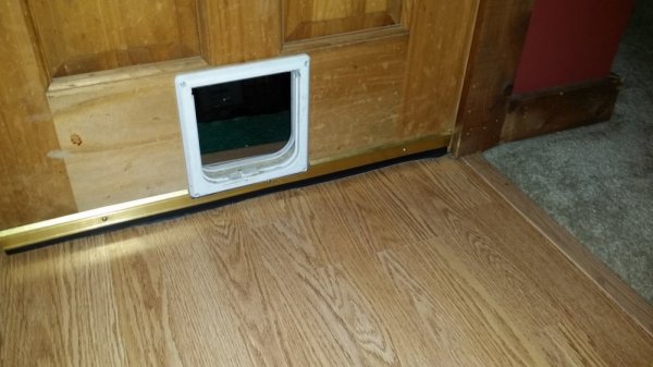

    I leave my basement door closed and remove the flapper for our Cat door. It works great!
    Just let me know and I'm there!;
    I already removed my door in preparation for this heating season. :)

    I thought about adding a louver/vent in the door.
    The kitty litter box stays in our basement. :) So I had to install a door. Timber use to use it (My Shepard puppy). But that was only for about a month. He is almost 8 months now and over 84 lbs. :thumbs: He is going to be a big boy! :)

    Interesting cat door!Have no mouse protectors(right now) have to post a picture of mine,through the side of the house!
