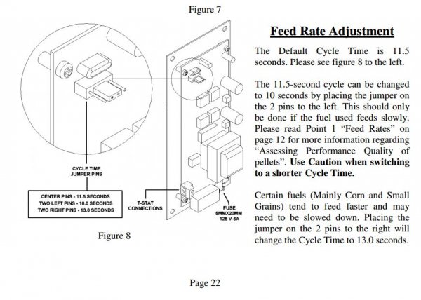

    Looks like the board you have is an older unit. The control board doesn't match whats in the manual from the web site. I'm digging to see if there is an older manual kickin around, But I think the jumpers on the back are different programs(feed rates).

    If the switch is doing exactly what the jumper did then it should act exactly the same as the jumper assuming you have good connections and no solder bridges, as jtakeman says that doesn't exactly match the manuals online.
    That controller looks like mine to some degree and if it sort of is the same those jumpered pins select cycle timings.

    I found this in a 2009 control board manual. Its what I thought, They are for the feed rates.
    I'd have a dig through this manual to see what it might have to help ya. The PDF is too large, You'll have to download from link posted.

    Thanks guys for clearing up what those jumpers are for. I've had it with this thing for tonight. I'll work on it again tomorrow and see what i can figure out. Thanks for that manual jt. It's got alot more info than the one's i've found.

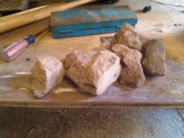

    Wellllll, i discovered one more clogged area in the stove. Don't know how i missed this one but i honestly thought it was supposed to be there. I tried to pull the ash clean out rod the other day and noticed that the grate wouldn't budge. I kept looking at the screw that attaches the shaker plate to the clean out plate thinking i had something in wrong because it seemed like the screw was stopping it from moving. When i first started cleaning this stove out i reached below the ignitor to check for ash buildup but it felt like a wall below it and i thought nothing of it. When i originally pulled the versagrate rod it looked like some type of hard insulation inside the hole that the rod went through. Turns out that "wall" i felt and the "insulation" i saw was a solid block of ash! o_O I had to break it apart with a screwdriver. Now the ash cleanout works just fine :emb:
    Here's the culprit

    WOW

    Holy shiznits, Are those bio bricks?

    That stuff is like "petrified wood" (ash) lol..
    Hard as a brick!!

    Pretty much! I'm not kidding when i say the entire area in front of the burn pot was jammed solid with that stuff. It felt like part of the stove. A few of those pieces were actually tough to break apart.
