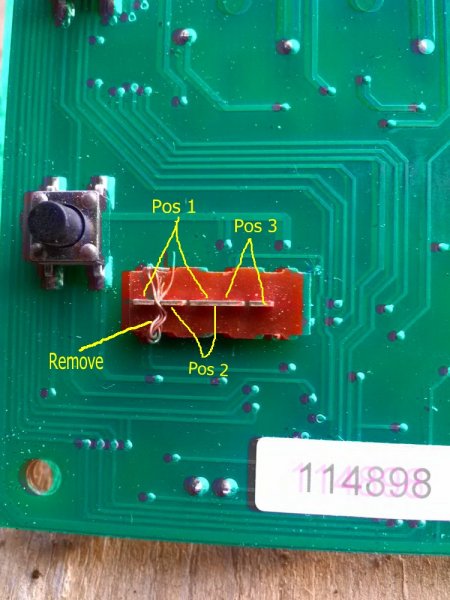

    The jumper you have placed isn't correct. The wide bar is the common. See pic for where you need to jump for testing.

    JT you are the man! Now in the photo you indicated the correct jumper on, the board is actually upside down. For me to try and run it in manual mode would i still jump it as POS 1? That would be like the switch is all the way to the right in the "manual" postition right? Thanks for tracking down that switch for me. Gonna see what i can do about ordering one.

    I just marked it the way it was pictured. You need to see what the face plate says for manual and orient the board as it was installed. Then you might need to swap pos 1 and 3. 2 is the middle setting on the switch either way.

    oh ok yea i guess it doesn't make a difference if it's upside down or not. Either way i need to jump it like you said. I'll give it a shot in the morning. Thanks again

    Jt you were definitely right about the wide bar being the common. Both ways I had it jumped before were still telling the stove it was in t-stat mode. I jumped pos 1 like you said and it finally burned past the 1hr shut down I've been experiencing. That's definitely "manual" mode. Thanks again

    Got the switches in today and rather than try to solder the new switch in, I carefully took just the slide/contactor piece off and snapped it onto the board. It's currently running (in manual I hope) and i'll see what it does after an hour or so. Keeping my fingers crossed! :tears:

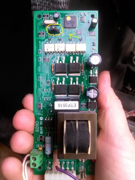

    Im still having the 1 hr shut down issue after installing the switch. I read in the manual from eventemp in (which is for models with an older control board) that the stove is set from the factory in "smart stat" mode. To run it in "manual" it refers to removing the factory installed jumper. Could this be a jumper on my board keeping the stove in "smart stat' mode.The black plastic piece is removable Im not having any luck communicating with st croix's tech department.
  20. SmokeyTheBear
    SmokeyTheBear
    8,306
    39,363
    Standish, ME
    Is the switch installed correctly, that is are the switch contacts working exactly like they did when you used the jumper on the busted switch?
