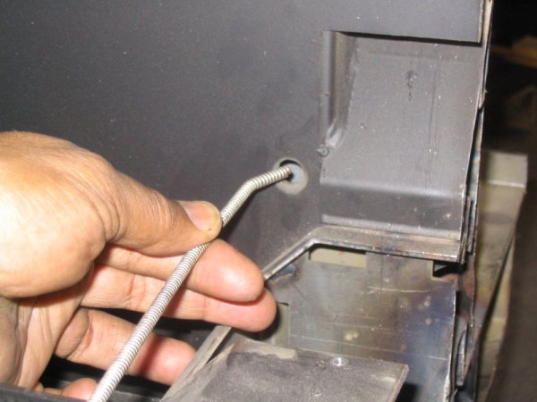

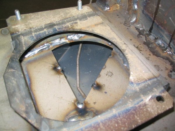

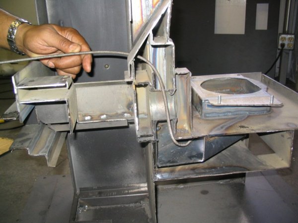

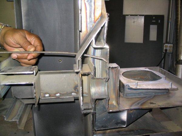

    Thanks for the info @Rona and welcome to fhc! Yes my stove has two small holes on each side just above the burn pot. I have blow gun with a flexible copper line that I snaked up those holes and let er rip for a while. The soot and dust that came out was unbelievable. I'm pretty sure I got the stove as clean as possible but wouldn't mind looking at the cutaway photos you have.

    I think I still have them somewhere? May take some time to find. Unless he has them handy.

    I found them and with my wifes help I think Smoking Piney should be getting them. Ron A

    Here's the auburn cut away pics. Thanks again Ron.

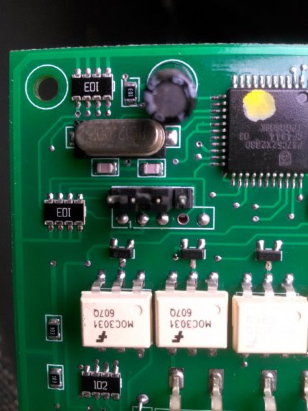

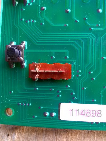

    Bingo! Right after I posted that I remembered that the mode switch was a little loose so I took the board out to check it out. Turns out the switch had come loose from the board and the contactor in the switch was missing :(. So it's stuck in "pilot mode". Burning on low setting even though the heat level was showing 5.

    Im guessing a small copper contact goes in that recessed spot in the switch (pic#1) and it connects at the three different tabs on the board. Also in pic #1 on the little orange part, the top tab is smart stat mode, the middle is thermostat mode and the bottom two are manual mode? That's how it seems it would be if the switch was connected. I'm gonna try my best to fix this before i have to order a $300 board for a freakin solder in slide switch. :mad:

    Any numbers on that switch?

    No number on the switch unfortunately.

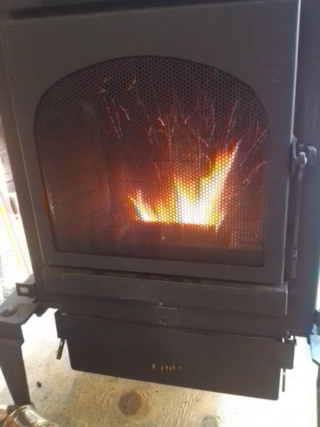

    I wasn't going to let this thing beat me today so I came back out to do a little test. I stuffed some copper wire between the contacts that I thought were "manual mode" and plugged the board back in. After the normal start up she's now burning hot on level 5:D. Now to figure a better way to connect them without soldering them together. I don't want it to permanently be in manual mode. Here's how she's supposed to burn

    Wow!! Lots of sparks!
    You could probably close the damper a little and slow the burn. That will let the air flow slower through the system and give you a better heat exchange.
    Looks great! I hope it's an easy fix.

    That was taken right as it dropped pellets into the hopper. Should it not throw sparks like that when pellets are dropping? Well I got excited a little too early as i went outside after leaving it burn for an hr, the fire was out and the exhaust blower had just shut off and the power light was blinking. So i either have it rigged in "smartstat mode" or there's another problem. Smartstat mode basically get's the stove up to temp then drops to level 1. If it's not calling for anymore heat after an hr, the stove shuts down and the power light blinks. I'll get to the bottom of this by spring i swear! o_O

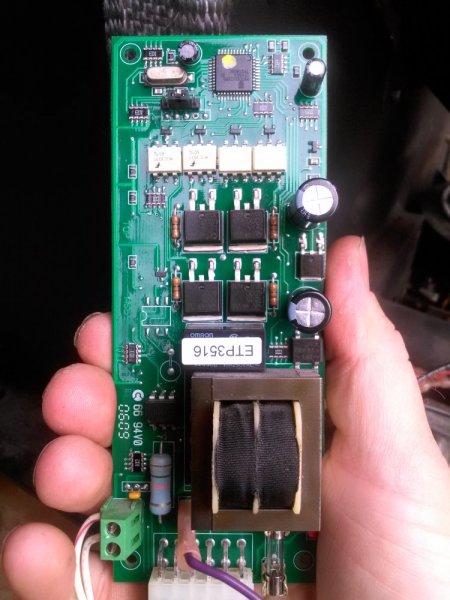

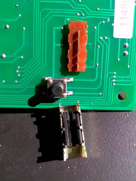

    Some of the older boards used to use jumpers and pins instead of the switch. Might be something to consider if you can't locate the switch.
    I'll look at my board and see if the switch I have might work. Might need to post a pic of the backside of your board to compare them???

    Here's the back of my board. The 4 solder points for the switch are just below the black piece center of 1st photo. They're kind of outlined by a white rectangle.
