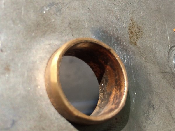

    St. Croix uses the old SAE 841 oilite bronze auger bearings that can get black and gummy inside. So pull that out and clean it up well and you should be fine. You can even upgrade it to a nylon bearing too!
    Click pic to enlarge.

    Don, is that the bearing that's in the plate near the motor? Or is there another bearing im not seeing?

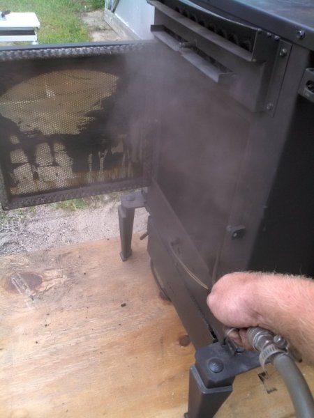

    Well today I had a few minutes after work so I wheeled the stove out in front of the shop and started to blow it out. Holy cow, the inside of this thing is dirty! I seriously doubt if he cleaned it at all. I hit it with air for 20mins or so and there's still ash coming out :eek:.
    I have to order the combustion blower gaskets, auger gasket and versa grate shaft gasket. I'm going to try and weld the worn versa grate pieces and grind them down to spec. If it works, great and if not I'll just order them.
