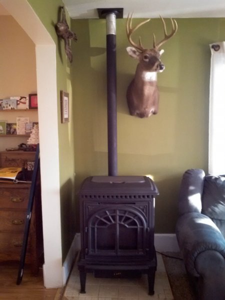

    Bogie already covered most of it. I bought mine used and neglected. It was totally gummed up so i did a complete tear down and cleaning, replaced a few parts and it's ran great so far. I did just replace the combustion /exhaust blower (it was making some racket towards the end of last season) but it's a simple stove to work on. My only complaint is also the hopper size. I use mine as secondary heat and still found myself filling the hopper quite often. Oh and so far it's not been very picky about pellets. Yes some burn better than others but it's eaten pretty much every brand I've fed it.
    I think you'll enjoy it! Good luck and put up some pics when you get it! Invite some strong friends over, this sucker weighs in over 400lbs.
    Oh did i mention it's a good looking stove! :cool: Don't pay attention to that unpainted pipe, it's black now haha.
