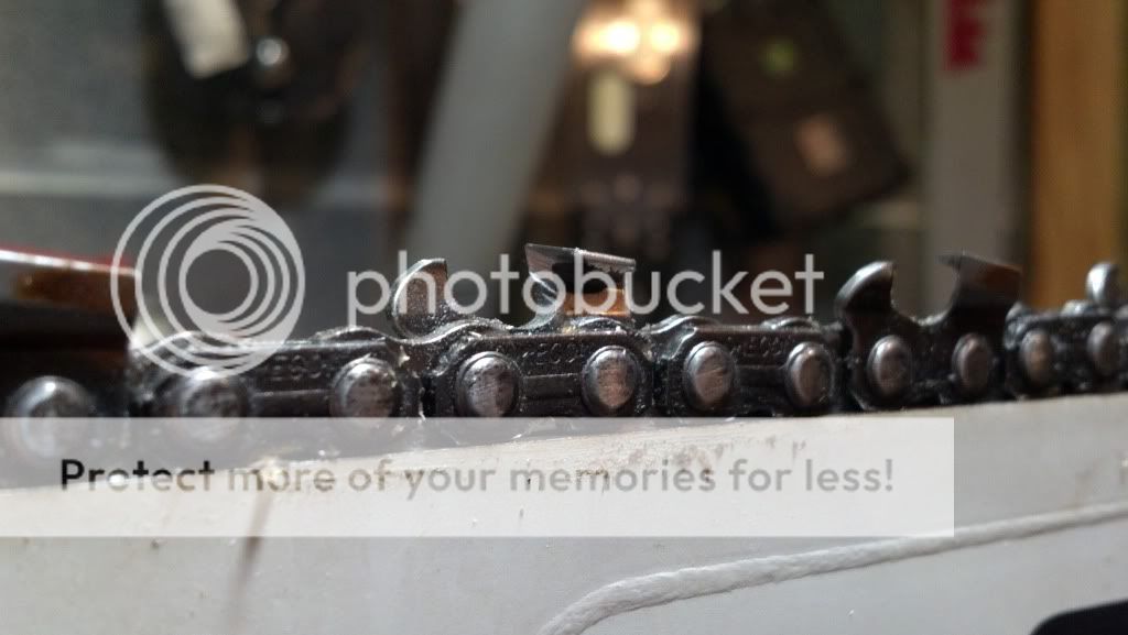

    Here's an Oregon chain that was filed once or twice.
    You can see the rakers on this one have been lowered and thinned on one side and the other hasn't been finished

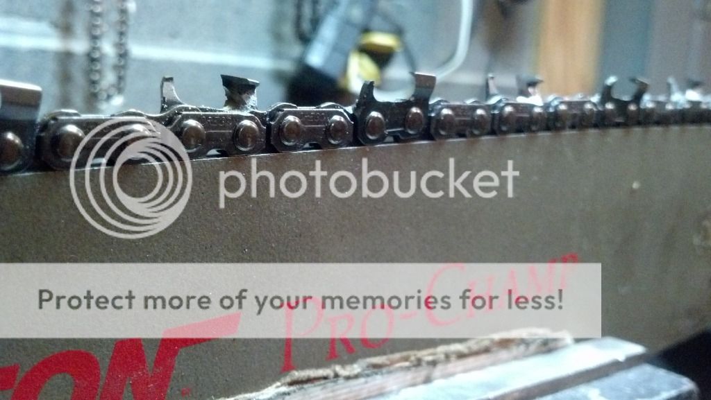

    Here was one filed, thinned rakers, and stoned. I think it was pretty fast according to Matt.

    Your last photo is interesting.....You stoned the outside corner for a razor sharp edge.
    It looks like you took off a little bit off the outside of the raker to compensate for stoning of cutter.
    Am I correct on that?

    Yes I stoned the outside and thinned the outside of the raker. That chain was one that was wow why didn't the others I spent twice as long on cut that good.

    See the shiny part on the side of the cutter in the last picture I posted? It evens all the cutters so they all cut the same width. Keeps the chain from pulling sideways as the cutters dig in. Square is smoother since both top and side is cutting. Round will pull the cutters more sideways.
