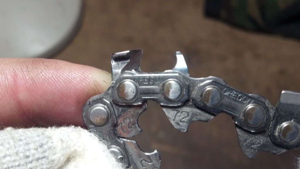

    Look at the rub marks on the rivets. You can see the marks on what part is rubbing in the cut.
    Skippy, Oliver1655 and DexterDay like this.

    Here's a picture and you can see the shiny part that is rubbing.
    Skippy, SAWMIKAZE, Moparmyway and 4 others like this.

    is that from the wood or the plastic buffers on the saw side cover ?

    I believe it's from the wood. The plastic pieces don't usually rub much unless a chain jumps off the bar. Either way it's friction on the chain.
