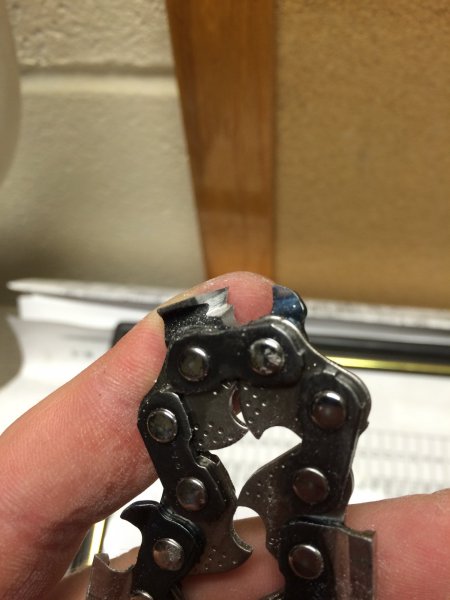

    OK, I broke down and decided to square file another 36" .404 to show the only difference that I can see (other than durability of the file itself) between a single bevel and a double bevel.
    Like already stated, the single bevel is thinner than a double bevel, however the single bevel does cut a taller side plate than the double bevel does. I did my best to take the 2 pics in the same light and at the same angle, but that aint easy. After taking these pictures, I cleaned up the gullets for use as a work chain.

    New York
    Thanks Kg461 ................ although I still stand in the shadows of some of the more talented square filers, I do like how my chains cut. Especially the .404 chains.
    The only time that I have seen the taller side plate come into play is when rakers are lower for softwood cutting.
    They might offer some advantage in a race, although I will leave that up to the experts to comment on.

    10,478
    There's not much cutting the side plate does. Probably the top 1/16" of it is what's cutting. If the chain leaves fuzzy ends when cutting g then the teeth aren't cutting even as they could be. That's the reason chains get stoned for racing to cut the same kerf and not pull the teeth sideways.
