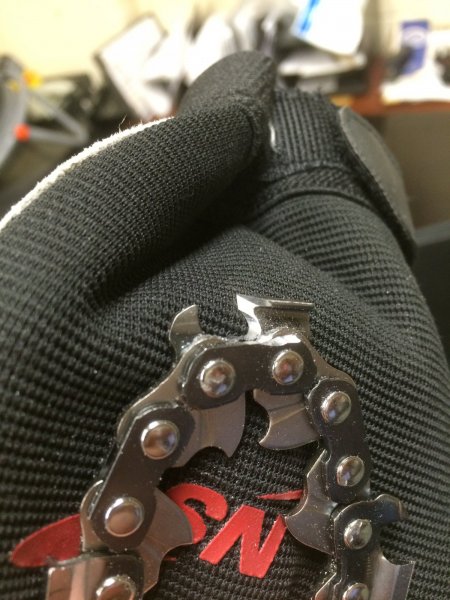

    I remember when the last ones that sold. I was out of the game at the time and didnt care. I passed info to Dennis and he bought a bunch, Cliff already stocked piled and I think Mike got some.
    Last of my unused junk because I will never square file again myself. I suked at it and dont care who knows. But if you couldnt beat my crap in the chain build off's you were hurting. ;)

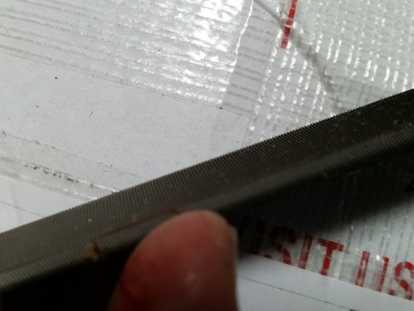

    I also used this oberg copied file.

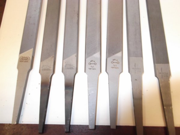

    The straight across teeth are smoother to start into a corner for me. Those double end from madsens work good and I carry some of them into the woods with me for touch ups or to file a burr off drive links if a chain is thrown.

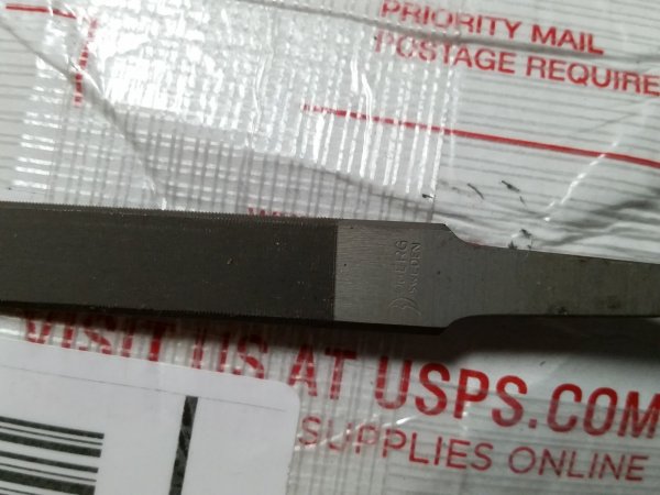

    Couple more pictures

    Save edge ............. if your finish has lines, you are pushing too hard. Lighten up on the last few strokes and its smoothe as glass
