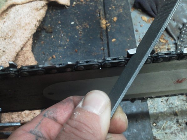

  8. trx250r180
    trx250r180
    Feb 6, 2014
    226
    701
    if i face the bar tip toward me ,can do the left cutters with right hand ,is that what you are calling back handed ?
    2 hands like this works on the left also ,one on each end of file
    Hedgerow and DexterDay like this.

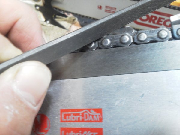

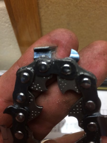

    Hold the file roughly 45 degrees to the bar ,now tilt the file so the bottom of it is barely touching the tie strap ,when you line up the outer corner of the cutter now with the file ,you should be in the ball park of where to swipe ,you were holding the file at the wrong angle so it was not sharpening the end of that tooth ,here is a bottom pic of about where to get the file lined up
    Skippy likes this.
  12. mdavlee
    mdavlee
    Oct 21, 2013
    4,380
    10,479
    You needed to get more towards 25-30° from the 10 or so you're doing. Lay the file on the tie straps at a 30° from the top plate. Slide the file til the corners match and you should rub the tie straps lightly.

    So go flatter with the file ? Ty for the help

    Yes..
    If you're cutting the hell out of the tie straps, your file is too steep..
    Just nicking them is no big deal..

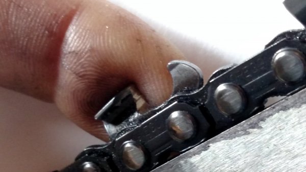

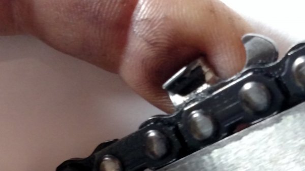

  15. Skippy
    Skippy
    Jul 23, 2014
    574
    1,108

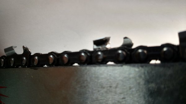

    How do these look ? Input still wanted I will try this out in the morning
  16. Skippy
    Skippy
    Jul 23, 2014
    574
    1,108
    Pics
  17. Skippy
    Skippy
    Jul 23, 2014
    574
    1,108
    With all your help I think I'm getting the hand of it . that little bit different angle made it so much smoother. I will post chip pics tomorrow from this mornings sharpening . hopefully it does way better .
    Ty
    Chris
  18. DexterDay
    DexterDay Administrator
    12,411
    31,634
    Northeast Oh
    It still looks like you are using the wrong corner on the file? Based on this pic you posted above.
    Place your finger behind the cutter or a piece of paper as Mike suggested. Gives the cutter better lighting and it easier to see.
    This drawing from Matt is a good one.

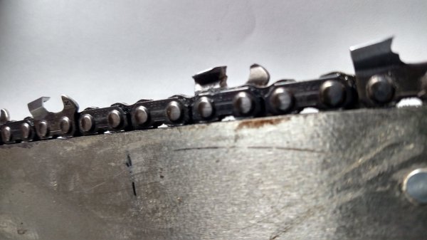

  20. Skippy
    Skippy
    Jul 23, 2014
    574
    1,108

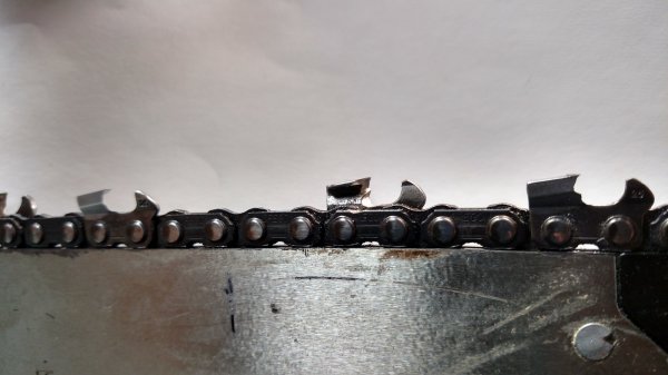

    New pics IMG_20150325_085305496.jpg IMG_20150325_085309611.jpg IMG_20150325_085305496.jpg
    Left cutters
