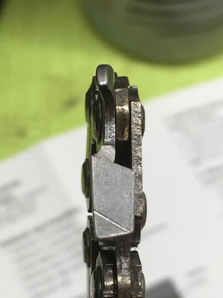

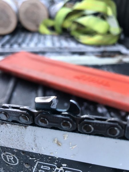

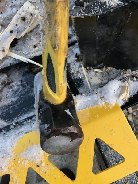

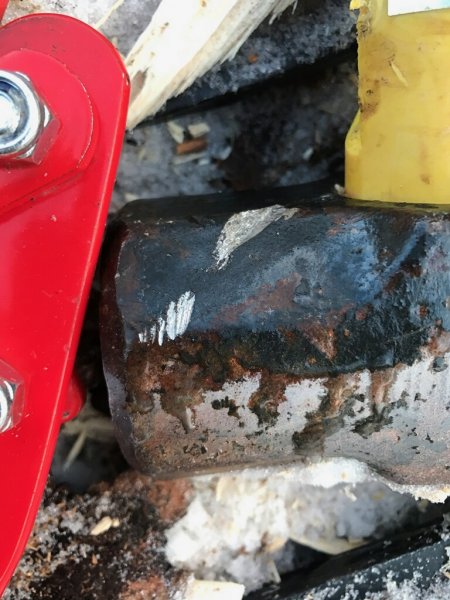

    789CEEEF-0F60-4E5E-AC03-41FB6C9AF0F2.jpeg 23A65494-F66B-426A-A6AB-557CD94CB950.jpeg
    chain was in Alaska and he cut more after the accident

    lol he said it was covered in snow
    still did some damage but ive seen worse

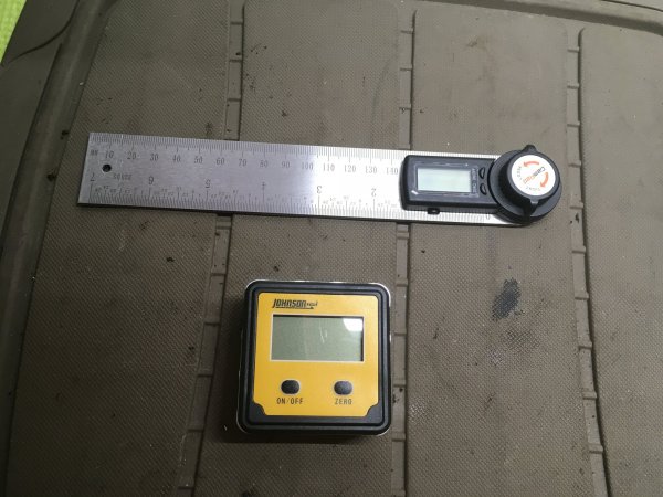

    I zeroed it out above the bolt for the swing arm. Figured that would be the best and closest area to measure at relative to the wheel, or should I measure zero on the wheel itself?
    Top plate dresser is at 28.7 degrees relative to the top of the grinder.
    The side plate is at 22.7 degrees.

    try taking the side plate dresser to 19 degrees and see how it looks

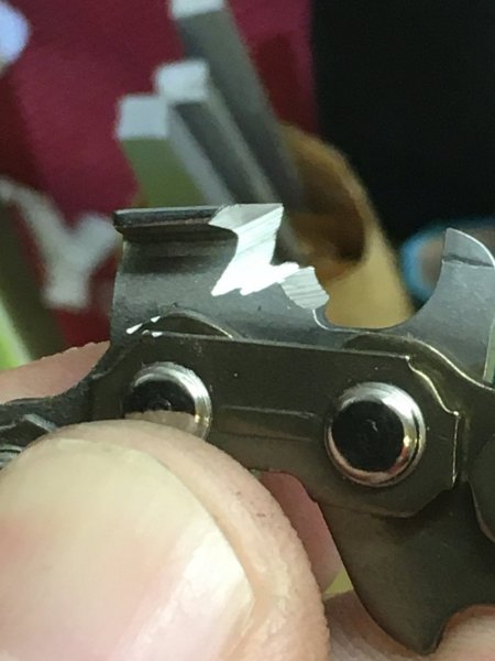

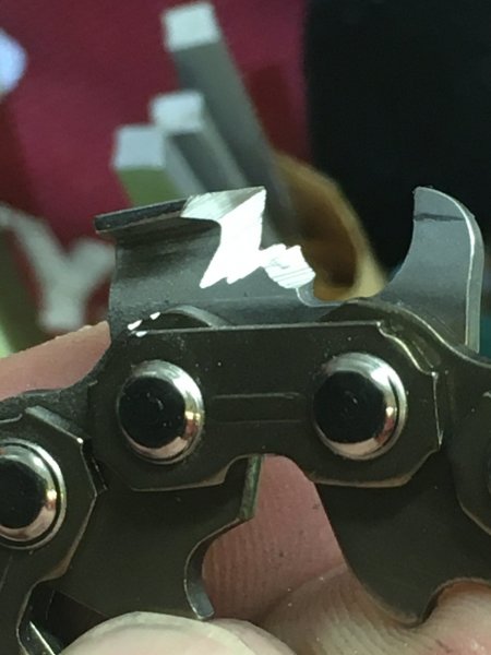

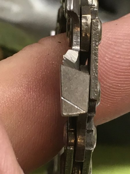

    Here it is. That’s 19 degree side plate. This is a Raisman chain I donated to the cause of learning.

    Awesome. The top plate ended up at exactly 20 degrees with this set up.
    I’ll get a chain ground this weekend or something.

    the less than stock top angle helps durability

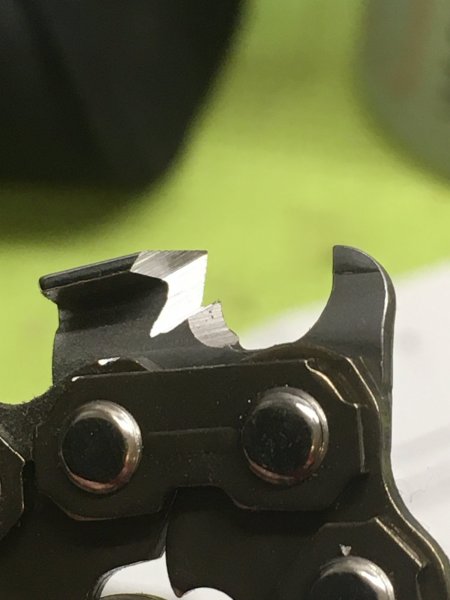

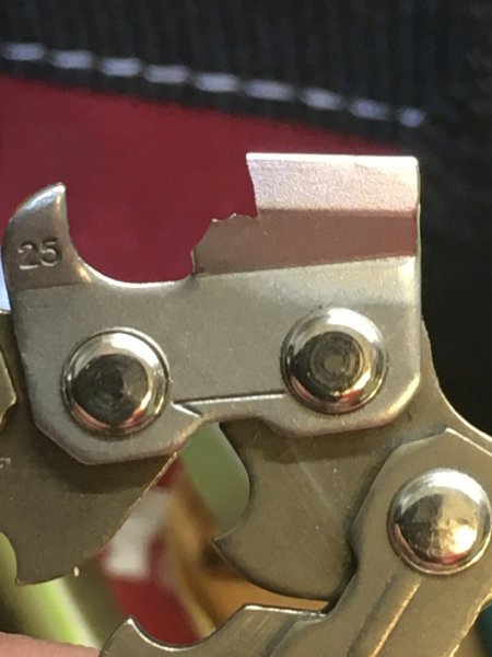

    This is a fresh one that hasn’t been ground on before. Looks pretty good to me.
    it takes a decent amount off the cutter to get the top plate that shallow. 7DE30C77-E3A8-4844-920A-87B10ED1FAAE.jpeg 26B43390-7EF9-48C3-AD1C-8AF49C671934.jpeg

    yes it is changing the angles but once you are there it wont take much from now on
