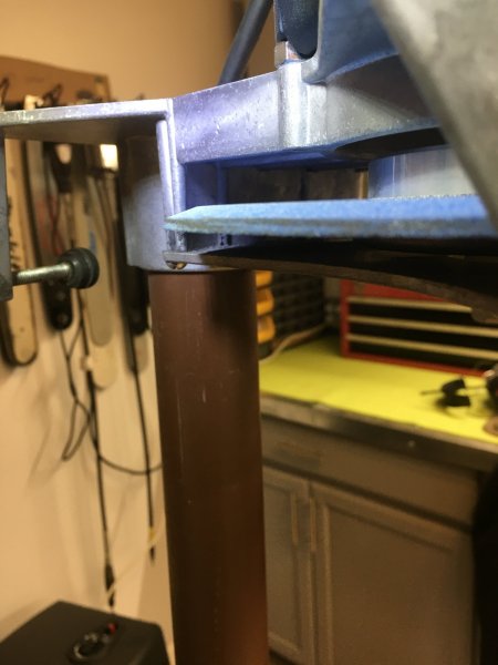

    This last one was done with the holder all the way back, and the arm all the way down. Lemme’ go and take some pics. Hang on.

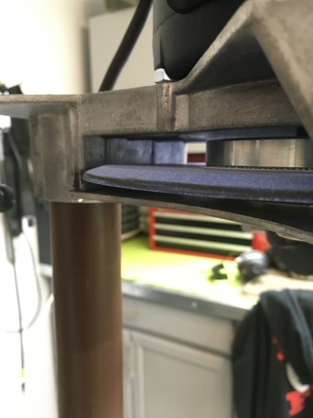

    Here we go. This is exactly how it was set up for that last chain.

    id say your wheel angles are around 25 degrees or so for top plate ant atleast 24 on the side plate
    im at 20 on the side and 15 on top and arm stuff about midways for a 3/8 work chain

    So dress the top plate “flatter” and the side plate “steeper”? I haven’t played much with the top plate dresser. Mostly with the side plate.

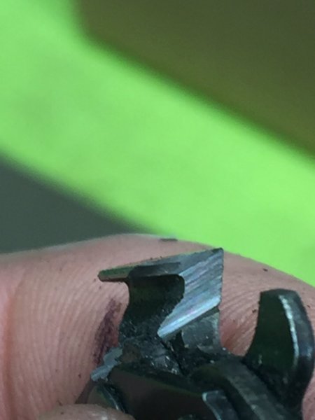

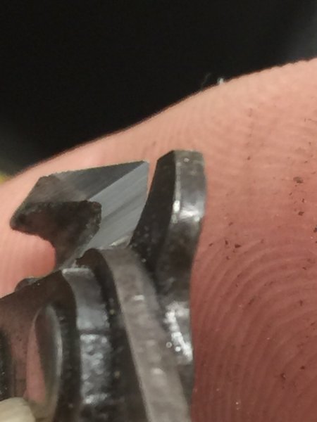

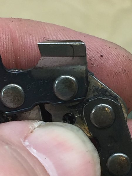

    This is a tooth I ground the first day I got it. Can’t remember the settings, though.

    the good thing about these compared to the older 450 is the ability to have different set ups and accomplish the same cutter
    yours is not wrong and mine isnt completely right
    but yes id play with the side plate some to take out some of the forward lean and just make little tweaks keeping notes on each step and what works and what doesnt

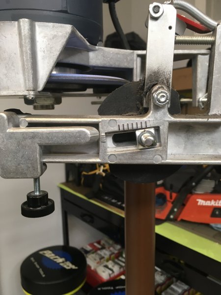

    That’s kinda what I’ve been doing. I’m going to make a template, or something, that’s graded to make adjustments easier to record. I figured something for the dressers would be handy. But, then again, I could just record the degrees with the angle finder. Overthinking it. Lol

    That was the first cutter I ground with it. I agree, though, unnecessarily tall side plate and the wheel is easily too thick and easier to hit the straps.

    the angle finder can be laid on the aluminum block holding the dresser or if dresser is extended can be put right on it
    zero it out close to the dresser on the motor plate
    the angle finder helps alot even if just for reference points
    you could use a scribe to mark the motor plate at the adjustment blocks if you want more than one wheel dresser angle

    That’s exactly what I was thinking. I figured marks like 1-10 or 1-5, something like that. Just to make it easy to change the setup.
