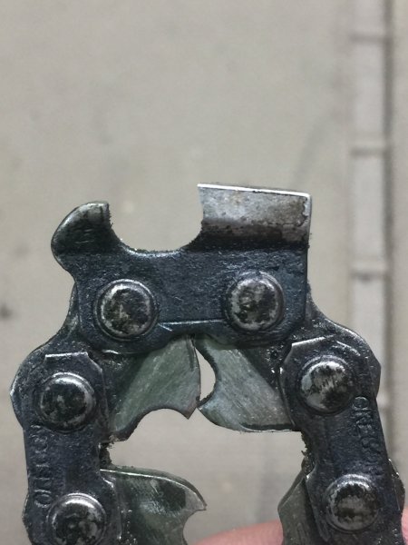

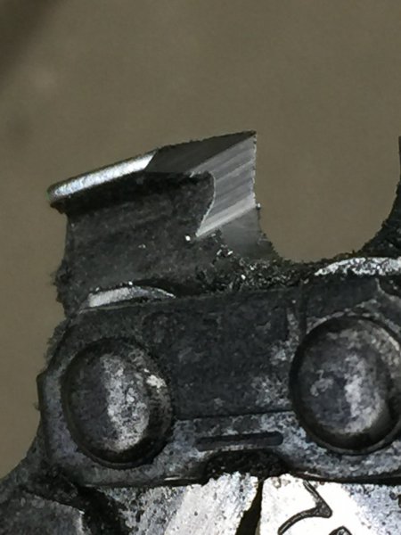

    Here’s a couple I’ve done. I don’t know why it double posted the first set of pics.

    johnson level 1886-0000 magnetic base
    this is the one i have link didnt come through though
    the chain looks good maybe a touch too much forward lean but you are very close to what i use

    Thanks Dallas. I’ll pick one of those up. I agree on the forward lean. Just a little too much.
    I ran one of the chains for just a couple of cuts today. Feeds very well, and seems to be cutting great. I’ll take a pic of the one I ran tomorrow, it may be a little different than the pics I posted.

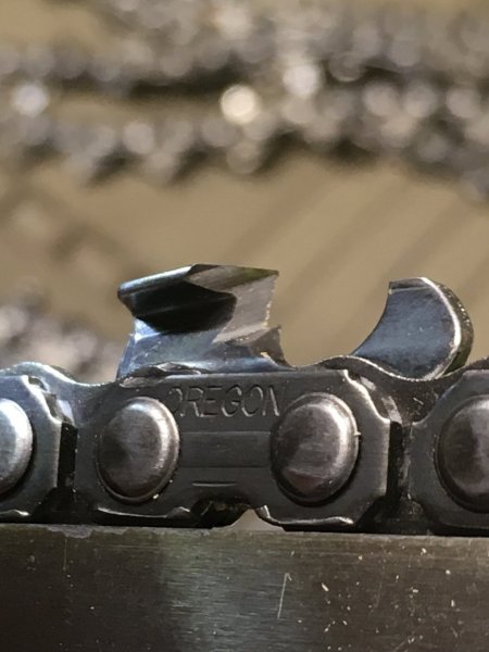

    Here’s the chain I cut with yesterday. I guess it looks more like the first chain in my previous post. A little too much forward lean. It fed real good, but with that lean it should too. The top plate is more aggressive than on the first one in the other post, though. I know I dressed the side plate on the wheel to less vertical, so that makes sense. Rakers are at .030-.035.

    that will be fast but wont be as durable in hardwoods need about 1/3 of the forward lean that you have
    what saw are you running it on the bottom part of the side plates look really worn for a almost new chain like its being ran tight or low oil flow

    Yeah, that one’s got too much lean, for sure. It’s been run different saws. I don’t have a loop for each particular saw. I see what you’re saying, though. Interesting.
    I made two cuts with it yesterday, and checked the oiler on start up. Was doing just fine. Im gonna see if I have any other chains that look like that, or if that’s a one off.

    what does the top of the cutter look like what angle do you think they are ?

    I’d say the top plate is at 22ish degrees. Guesstimate.

    my 3/8 is 26 degrees my 404 is closer to 15 degrees
