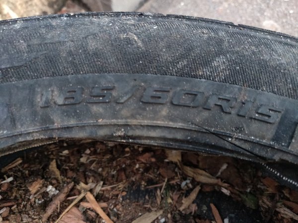

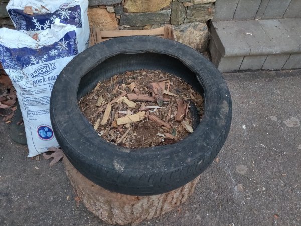

    My original tire finally fell apart after 487,958 strokes and I replaced it the other day. The original was 195/65/15......and the new one I found at the tire shop is 185/60/15......so slightly narrower which means less tall on its side. I would have preferred wider but that was the only 15" tire I could find. Also I figured out that cutting out the metal band in the center is much better for your axe. I was getting mine all dinged up from hitting it. Also by removing it the tire has bit more flex to it and that's super useful for those splits that are a tight fit that otherwise were getting stuck after I split it. This gives enough wiggle room to easily remove the wood.
    If I have non-cooperative wood I put it aside until I have a nice pile for the splitter. Today I lent my splitter to my neighbor and so since it was out I decided to use it to split a bunch of beech rounds I got as well as the aforementioned splitter pile.
    Having processed what has to be 40-50 cord in the last 14 months and say 80% of it using the tire, I am absolutely loving it. To each their own. I didn't start this thread for any other reason than to share my experience with the tire. I'm sure the people who operate a lever only enjoy their process as I do mine. Keep on hoarding everybody!
    Old:
    New:

    Thanks man. Where the tire meets the rim there is a metal ring. I cut it out by using a utility knife. It's not the easiest thing to do but if you take your time and lift up the edge of the tire with your other hand it makes it easier and kind of pops open the cut....kind of like the cross cross method of slicing a mango.
