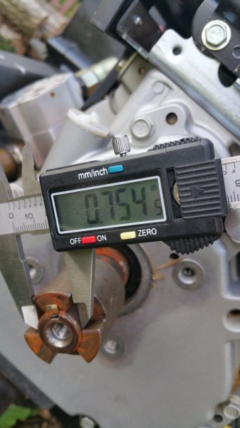

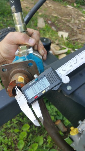

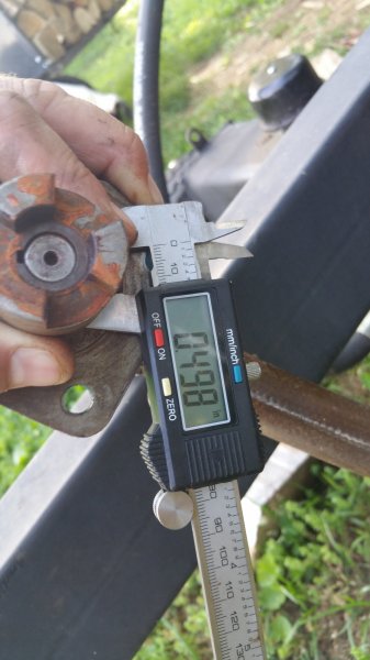

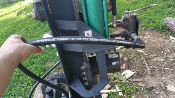

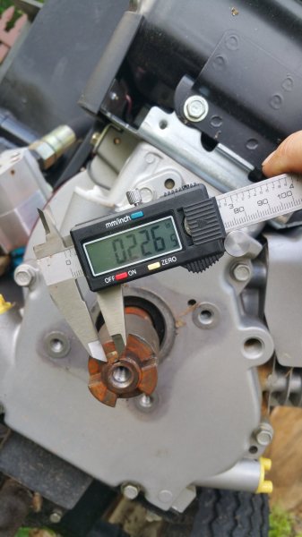

    Sorry for the delay guys here are the pics.....
    It looks like the rotation is clockwise per the recoil direction.
    The crank looks like .75" with a .25" key way.
    The pump looks like a .50" shaft with a .0125" keyway.
    Bolt spacing hole to hole on the motor is about 2.5" and on the pump side of the bracket is 2.0"
    Am I on track with this stuff?

    Measurements all look good to me. .0125 = 1/8.
    I'd say you are barking up the right tree with the kit.
    3 jaw should work fine. Do those couplers have a rubber dampener?
