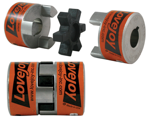

    With 6.5 HP I'd go with the 13-16. Shouldn't work the engine to hard. Rotation does need to match the engine. I've flipped the gears in pumps to change the direction though.
    Im not familiar with your coupler. Is there rubber bushings between the cogs? If not I would replace it with luv-joy since your engine load will increase.

    Lovejoy? Pics?

    Yeah, of definitely go with a Lovejoy, or marginally with a damper in between the coupler halves.
