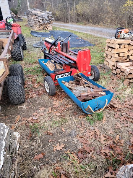

    Oh, here's another "mod"
    Simple but catches all the splitter trash and bark/ debris that ends up in the grass.
    upload_2025-10-4_17-5-16.jpeg upload_2025-10-4_17-5-16.jpeg upload_2025-10-4_17-5-16.jpeg upload_2025-10-4_17-5-16.jpeg upload_2025-10-4_17-5-16.jpeg upload_2025-10-4_17-5-16.jpeg
  7. TurboDiesel
    16,241
    97,581
    Barrel halfs were too slippy and awkward, so Had to add rope handles to drag/lift the full barrels.:handshake:
    I just flip the gate down on the atv trailer and drag the barrels on then run up the mountain and dump the junk in a hole on a path somewhere. The junk is great for drying up a muddy ditch across a trail.
    WinonaRail, eatonpcat, Horkn and 5 others like this.

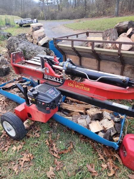

    Like the pivoting feature to fuel up! I have to tilt the ram vertical to expose the gas tank.
    eatonpcat, Horkn and T.Jeff Veal like this.
  9. Horkn
    29,224
    166,820
    Yeah that's really slick. Work tray and engine guard all in one
    eatonpcat and T.Jeff Veal like this.

    That's a slick little walking beam trailer too! I think you showed it years ago, but you know.... the memory thing. :whistle:

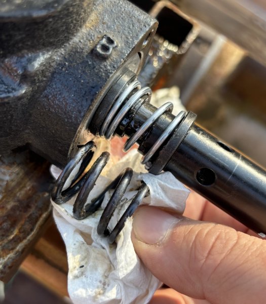

    My latest mod is a lighter spring in the ‘extend’ side of the valve. It now only takes one finger tip to move the lever and the reduction in arm fatigue is amazing. Still getting used to how light it is. Sort of like going from a gritty 7 lb trigger to a nice crisp 8oz ‘breaks like glass’ trigger on a rifle. I cannot say enough about this mod. It is right up there with detent returns and 4 way wedges. Definitely a must have.
    It is an easy mod and only takes a few minutes. To keep oil from spilling, move the lever to the return position once you get it stripped down to about this stage. I am not sure if there are different sizes for springs, so measure yours and find one that fits.
