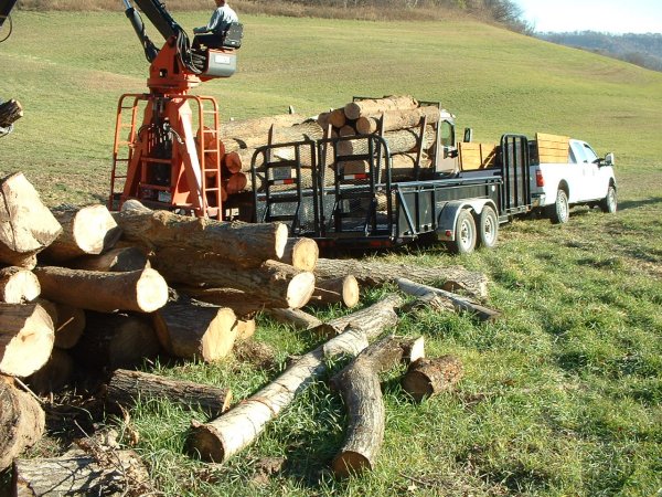

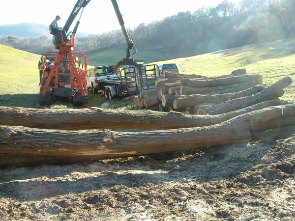

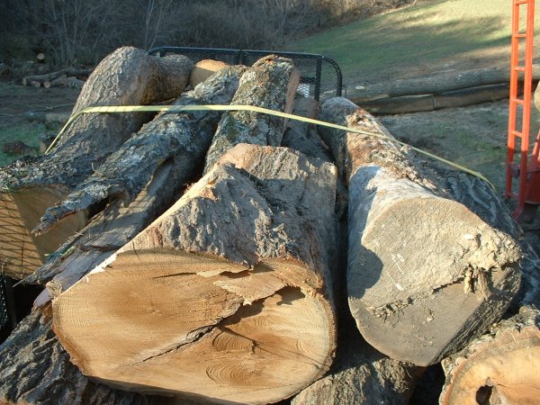

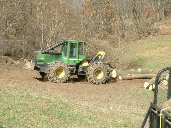

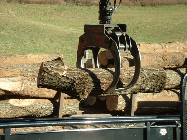

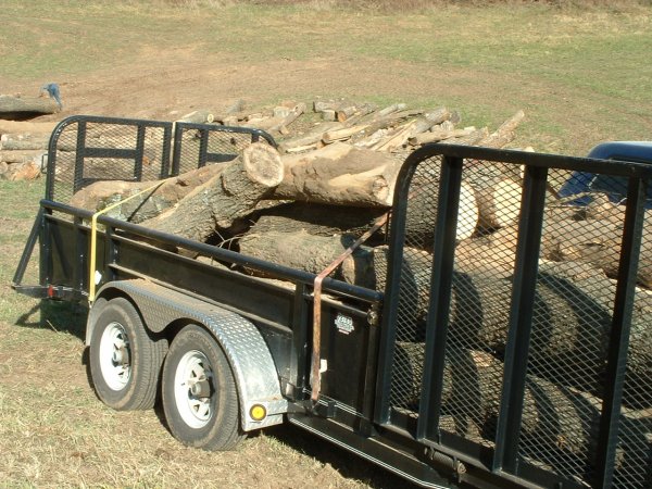

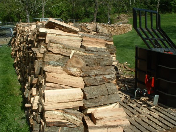

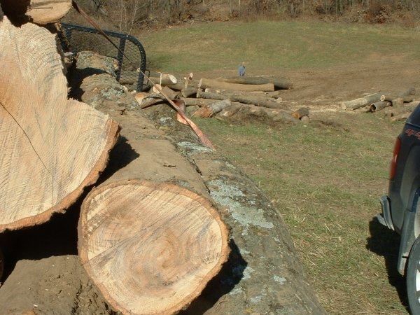

    My logger buddies called 3 weeks ago and told me to "come get some wood" as they were in the area. I turned them down, I've got enough for the year and the yard was soft then. It is pretty easy pickings when they load for me. This was the last site I cleaned up.

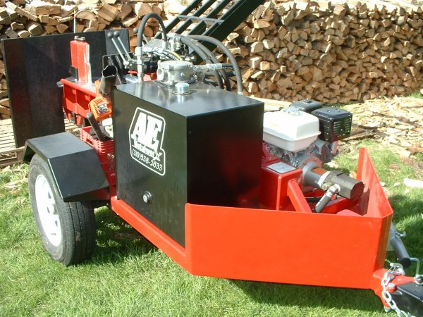

    Sure it should be run at WOT which would be 3600 RPM. But most of the time I split in the Winter time and it certainly is going to run hot. WOT also will put more heat into the hydro fluid too. The other day is was much warmer than normal and it was 80 degrees out. The hottest temp I could find in the oil system was 115 and that was the hydro pump itself. After 3 hours of running another day the hydro tank was 110.

    Now you guys have me wondering about partial throttle or WOT operation.
    I am looking at a Honda GX390 manual right now, but it won't allow me to cut/paste the paragraph. But I will retype if verbatim:
    Position throttle lever to the desired engine speed.
    For engine speed recommendations, refer to the instructions of the equipment being powered by this by this engine.
    So Honda in the owner's manual does not dictate WOT and no mention of overheating if it is not done. As I said running this by myself is inefficient due to much of the time the splitter is not doing anything. One really needs 3 people minimum to get max results out of the splitter. Running the motor slower just runs the pump slower which certainly is going to hurt anything. It is not like a fan cooled hydro in a garden tractor that requires high RPM to cool another component. In this case running faster will make more heat in the hydraulic system.
    mat60 and Horkn like this.
  9. brenndatomu
    25,299
    164,684
    It won't overheat running at partial throttle...I rarely/almost never run mine at full throttle, its been fine for the last 8-9 years that way...

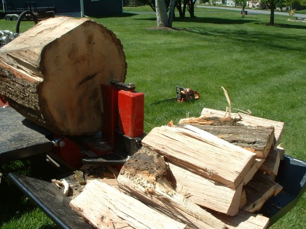

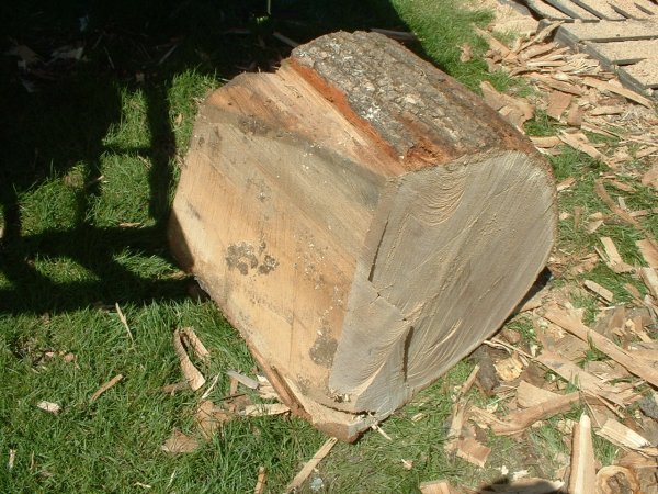

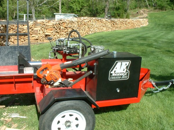

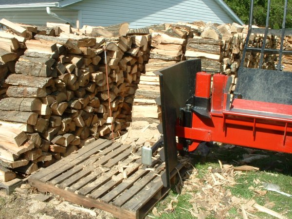

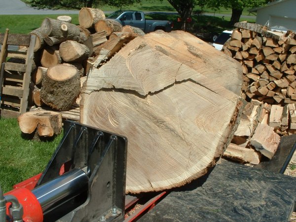

    Well I am done for the season, finished today. Way later than usual. It was super cold in Feb. and I had to use a small 25 ton splitter for about 2/3rds of the pile. Put the log lift to the test today with a large round. It was so big I could not budge it off the cut end and had to get a cant to get on its side so I could roll it. Note the size of the branch coming out of it. Blew it off with a leaf blower will wash tomorrow. About an hour before I was done ran low on fuel intentionally and topped off with 100LL aviation fuel for Summarizing. Will wash tomorrow, remove the push plate stop to fully retract the cylinder and then cover after collapsing the tongue and log table.
