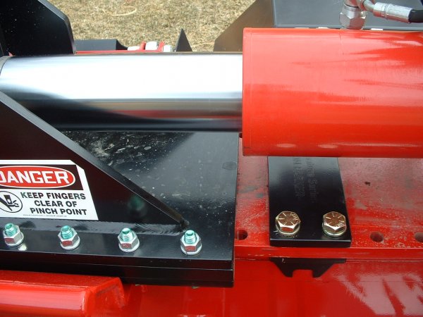

    How does the stroke limiter work? Does it move the valve to centre when it returns?

    Having a 30" stroke would really increase cycle time. So there is a plate that just stops the push plate from going all the way and it kicks out just like it would if it made the full circuit. DSCF0020.JPG

    exactly. One could make a provision similar to this on most splitters, however, most have a ~24" stroke and if cutting 20" firewood you won't be saving much. If you cut your wood 16" on the other hand........

    You are correct it wouldn't save much on a 24" cylinder, but this is a 30" for more flexibility. In you example saving 4" isn't much, but 10" in both directions adds up.
