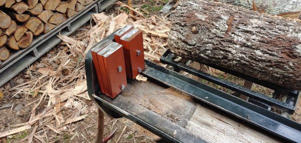

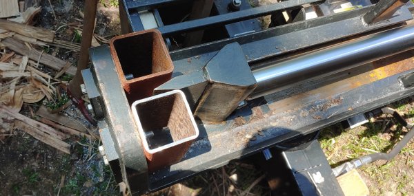

    I have been splitting some stringy hickory and we have some elm coming up too. Made an extension so the blade goes thru the wood.
    Did the first trial with 3" tubing, worked ok but one piece got bent a little 0810201302.jpg
    Trying some flat bar stock now, stacked 2 1/2" thick now. Seems to work better. Not as pretty a job as Screwloose or Eric Schamell would have done. Going to do a bit of grinding to finish it up. 0813201027.jpg

    Nice work Jeff!
    Bar stock definitely won’t be bending anytime soon. :yes:
    Any chance you could countersink those bolt holes & swap out the hex heads for countersunk bolts?

    Wouldn’t the bolt heads bite into the wood to keep it from sliding. I think I would leave them for that purpose.

    I’d be concerned about shearing them off tho as well.

    I don't think so. They are 7/16 x 5 1/2". I think they help hold the wood. It did slide some on the tubing...
    If they shear, I'll put in 1/2 or 5/8 bolts...

    Thanks, I cut the tall piece off this morning and ground the edges, beveled the inside edges too. Wedge nipped a corner yesterday...:picard:

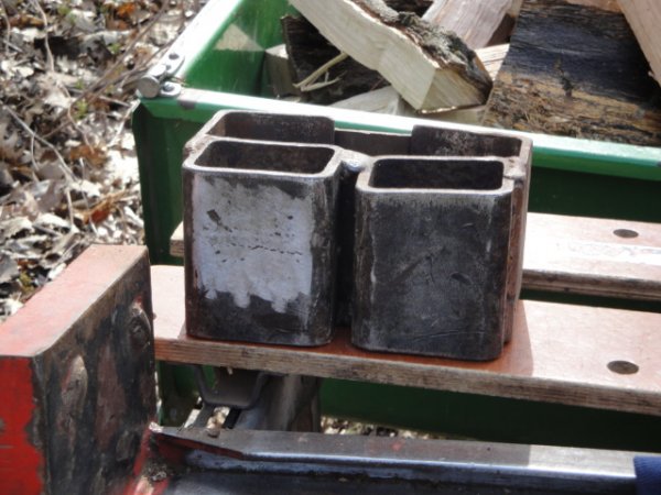

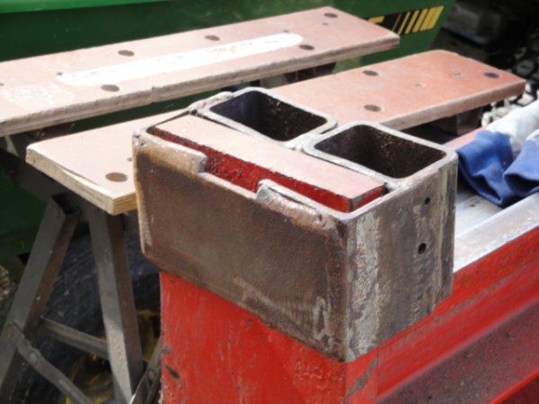

    I bent the original foot plate and beam( plus a little twist on my old HF unit) been upgraded since then. Bringing this memory up gets me wondering where I stashed the old beam and foot plate . I am not one to toss something like that.

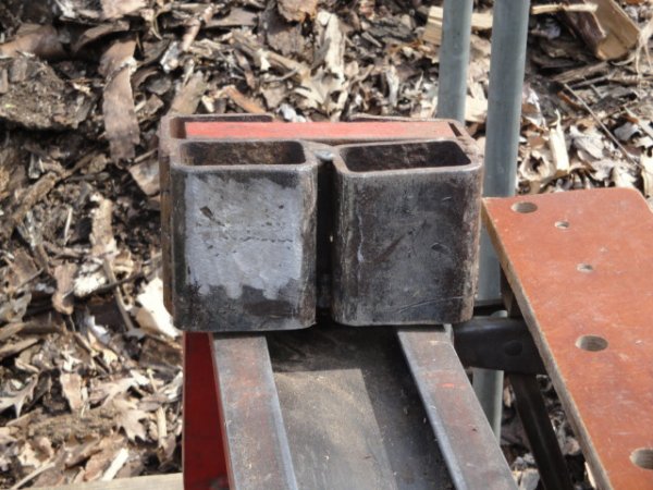

    I made something like that a number of years ago and it works great. Mine just slips over the foot of the splitter so there is some slop in it where the wedge does not hit it.
    DSC01245.JPG DSC01246.JPG DSC01247.JPG Being removable allows for me to use the splitter vertically as well.
