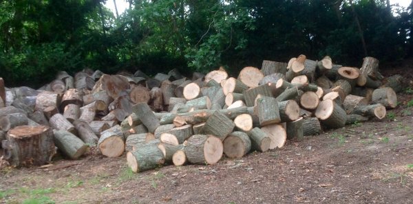

    So today it was supposed to rain all day however a cold front pushed through and it's breezy with no humidity.
    I planned on putting together a few more pallets and then splitting wood .
    Surprise!
    Two doors down the house just sold and the tree service was cutting most of the oak trees down.
    When they had the truck loaded with chips I went over and asked if I wanted to dump the chips two doors down of course they did when they asked me did I want the wood to so I took it
    They might have another truck load of logs and also one of chips so we'll see. I'll make a few more pallets because I got a lot of splitting to do.

    Wow Mike. That is terrific!

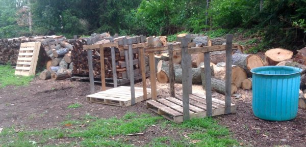

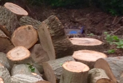

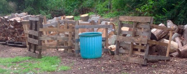

    Got the last of the wood and chips.
    Made up 6 more pallets for wood.
    In last pic what a waste with round cut so skinny. Hate splitting them like that!

    nice looking rounds..Very nice

    Yup. Those are a pain.

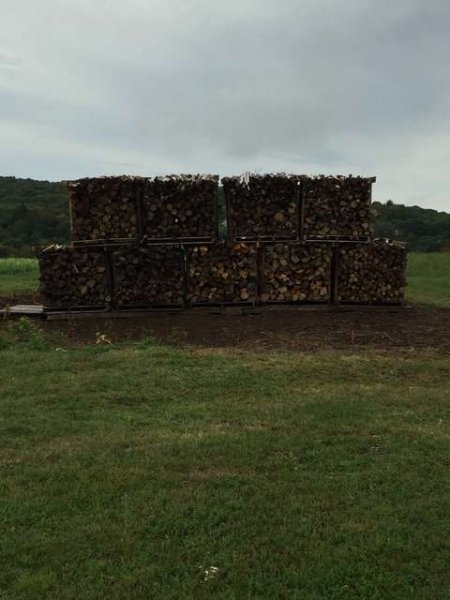

    I just assembled 6 more pallets this weekend and filled 3 of them with wood I had split but lying around. That gives me 36 assembled and 33 of them full! I am really liking this pallet rack system. This is my second year doing it.

    Deer Meadow Farm i've seen pictures your tractor and pallets before this and I love them
    it looks like you're doing something very similar to me.
    Are you buying wood to make the uprights on the sides of the palettes. I started taking pallets apart and using that wood to build the sides. I only use oak pallets to do this I find the softwood isn't strong enough to hold the sides upright .
    What I love best about this is being able to stack and move the wood around and manage things so easily .

    I get the pallets for free and buy rough-cut pine for the uprights. I cut my wood at 24" so I get two rows of wood. The uprights are centered on the pallet at 4' apart so each one roughly hits the center of the two rows of wood. I use a 4' 2x4 cross to tie the two uprights on each side together, then I use some (free) aircraft cable to tie the uprights together. I get approximately 56 cubic feet per pallet which is about all I can lift with my tractor. I'm looking to get some forks for my backhoe so I can feel a little safer when I stack them, especially when they are still kind of green.

    Deer Meadow Farm it's remarkable how similar we are doing these pallets. I use vinyl coated chain-link stretched out across the top of mine. My sides are half-inch or three-quarter inch oak removed from pallets. I cut my wood at around 20 inches so I get 2 rows on the pallets also. I have almost all red Oak so I can barely lift my pallet a foot off the ground when it's a full 4 foot high pallet. When I want to put a pallet on top I built the sides 3' high.
    The real big difference from what I can tell between us is that I split and stack directly on the pallet. In the past I would have a 6 foot pile of splits and I found it backbreaking to keep bending and stacking on a pallet. Now I skip that step and stack directly on the pallet .

    I stack directly onto the pallets when I can, but often it's much faster for me to process all at once and stack later.
