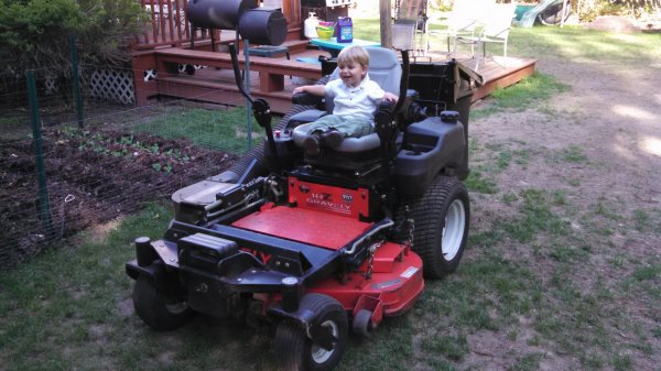

    I bought the Gravely, the thing is a beast.
    I think I did all right. Its a full commercial grade machine, independent hydros/ motors.

    Congrats. Good looking machine, I never see Gravely's around here. I'd consider doing away with the weights, unless you're gonna hill climb with it. What size/hp is it?
    Oliver1655 likes this.
  16. cnice_37
    cnice_37
    3,211
    14,236
    44" 21hp
    Oliver1655, Eric VW and fox9988 like this.
