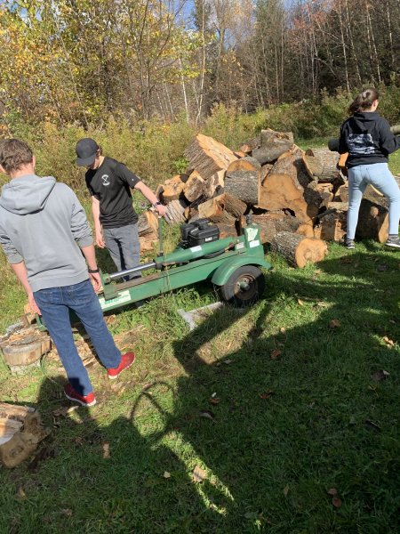

    F3E3A426-0479-4C02-AB5C-C0CD52BAE657.jpeg E9005F03-BD0E-4F10-A3C8-08889EB10423.jpeg 44A35836-9D60-4D98-BABA-1622B5E08463.jpeg
    the fall story continues.. I’m the shadow on tractor

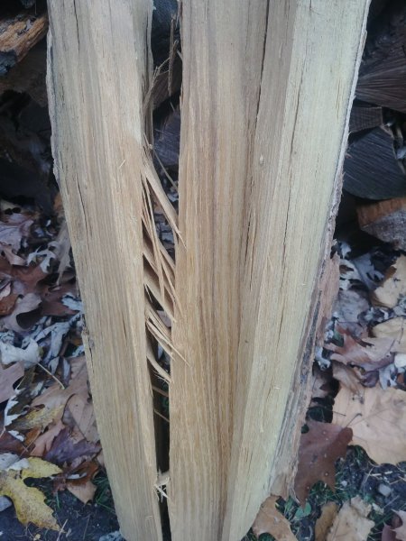

    Hi, this is an update to my last post a few years ago. I split all of the Locust you see in my previous post(s) by hand. So they've seasoned for about 7 years, if my math is correct. I found out a few things: This wasn't the easiest things to do, given I will be 60 years old next summer. Locust, especially really large rounds, can be difficult to split as it tears rather than splits, certainly not as difficult as the Hickory I have but certainly more difficult than the oak, maple, cherry and sycamore I've split(lots of very large hardwood trees in our neighborhood that get cut down once in a while. More often than not, nobody wants the wood so the tree companies search for anyone who wants free wood.). My Fiskers splitting axe was pretty useless until I split a large portion of each of the rounds with a much heavier splitting axe/maul. To make things easier and after many tries with different methods, using an old crane sling, wrapping it around the round or multiple rounds, and just tucking in to the bark so it holds, is the easiest and most efficient method I've found. It saves from having to bend down every chop and setting up the log again. In fact, after I'm done splitting a round, or a couple rounds together, the wood unfolds like an accordian when I release the crane sling-much of the wood is still attached by a couple strands which can just be pulled apart. I could never use a tire like some because most rounds are too big and sorry, I've never split wood where the rounds are perfect round. And yes, once in a blue moon I will miss my mark and come close to cutting the crane sling or actually hitting it but not directly.
    I added a photo of 1 round I split on a tarp. The other photo shows how I use an old crane sling to split the wood. When I release the sling the round opens up like a flower blooming. Another pic shows how the wood tears. I hope everyone is being safe and healthy. Firewood people are good people, sort of like people who love dogs, they're usually good peoiple too.....unless of course Charles Manson or similar was a closet lumberjack....Okay, I've rambled enough.
