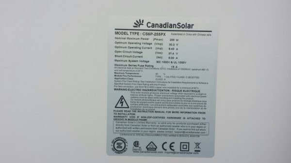

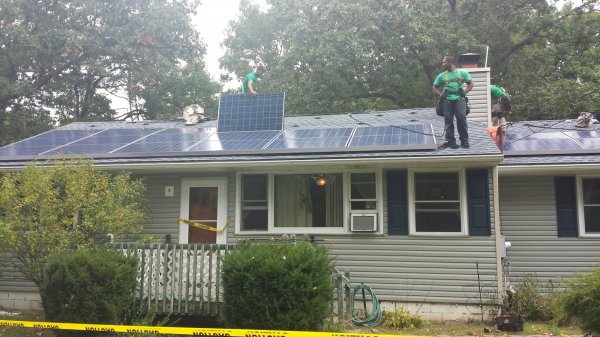

    And away we go ! Smokey I will answer your question when I get a little more time. Very happy to get 20150922_101427.jpeg 20150922_101655.jpeg Canadian built panels !!

    Built using parts from China (according to the tag in the picture) in China.

  11. jtakeman
    12,330
    55,580
    Assembled in China with Chinese cells?
    Not much build in USA yet alone North America. :shrug shoulders smiley here!!:

    Ya I just saw that too. The installers said they use Chinese and Canadian panels. I was happy to see Canadian panels. You are right JT not much built in US anymore. The car built with the most US parts and labor is........................................................................Toyota Camry.
