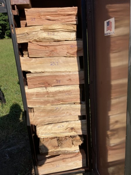

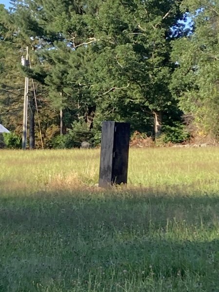

    So, woke up late. Went outside at 7.00 am and split up a largish Black Birch log that was in my mostly Beech collection. Readings from 21-25 moisture content from the few splits I tested while splitting. I was surprised it was that dry. Went with a larger log to get more moisture,,,,
    At the time the first pic was taken it was 7.30 am. Sun just leaving the box. I had left the door open about 4” because of wet paint. Paint job bites I’m well aware ;)
    68 degrees outside and the door was 99 degrees. Back of box was 71. Remember, open door.
    Stuffed it full of the birch and took some readings on the exposed split faces. Found one as high as 31.5 in some softer punky spot. Woohoo, I never cheered for higher readings. Closed it up.
    Came back about 40 minutes later and the door (sunny side) was 121 degrees. Back of box still low at 74. Then it dawned on me to take some temp readings higher in the box. Back of box was 85 closer to the top. Guess it’s safe to say the temp is building.
    I’ll take a few exterior moisture readings as time goes by. Eventually I’ll have to pull some out and resplit it to see that’s going on. Also not sure the door is sealing 100%. Maybe some strap tie downs for now. Cinch it down tight.

    First time ive seen firewood stored that way! Gives new meaning to the term "safe keeping"!:rofl: :lol:
    Unique experiment. Hope it works out.

    If you decide this method is effective, your field is going to look very strange with 50-100 black metal boxes in it. :rofl: :lol:

    LOL maybe, maybe. Mysterious monoliths are appearing across the world. Here’s what we know.
    We are talking some cutting edge out of this world mind blowing stuff here. I may be on the cusp. :)
    not planning on adding to the fleet. Mostly wanted an excuse to Get it out of the barn LOL
    If I could hold the temp long enough to hit 140 in the middle of the wood it will effectively kill bugs. That may require charcoal around the base.
    It’s also fun to watch the occasional car veer off the road as they try to figure out why there’s a tall black box in the middle of a field.

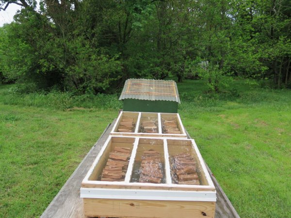

    This is what ya dry wood with. For cherry that starts at 15% it is dehydraded 0% in two weeks.
