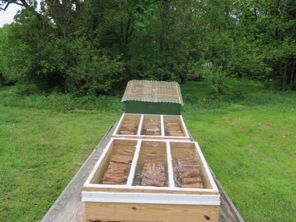

    The solar heating shouldn't be the problem. Its more important to pay attention to the air circulation.
    I built a passive solar box as proof of concept. Building an air solar panel
    Then I redesigned it to dry hardwood slices. Wood slice dehydrator Worked like a charm.
