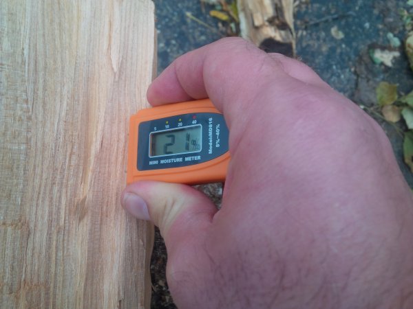

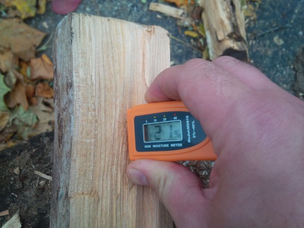

    UPDATE: 11/5/14 30% MC down to 21% MC in 60 Days!!!!!!
    This was a 8 inch split that I slit in half again and measured immediately. Another 30ish days, and according to accuweather we had another 15 sunny days. The wood has dropped to 21% MC from the 26% MC. The Control Pile that was top covered in a single row, windy, sunny location is sitting at 28% MC
    I don't need to burn this Cord, so Ill let it go for another month and see where it ends up, but this should end the silly debate about if it works or not.
