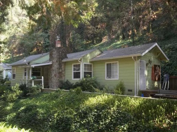

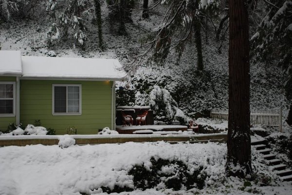

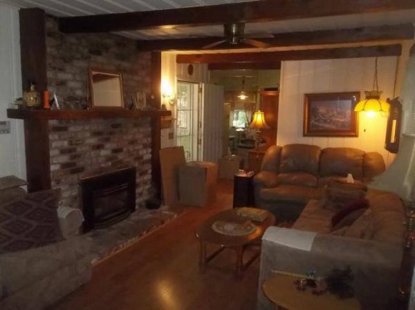

    Ask and you shall receive... a couple of pictures. Oh and thank you VERY much to the moderator who moved it.
    weatherguy, as you say, the impression I've gotten on cats so far is not that they are "bad" but that they add an extra burden. And that when they fail, it isn't good news.
    First is the listing picture of the mantle. The insert shown is Regency propane insert. The opening in the fireplace is ~31" wide x 24" tall. The picture is taken from the "master" bedroom while facing the other end of the house(kitchen and office). At the very far left about center of picture is the thermostat for the propane insert.
    Next we have fireplace from outside. The master room is the right side. The kitchen is offset and on the left of the picture. There is a lot more hillside at the top. Bottom of the picture is a year round creek.
    And the last picture is what I got to see twice during 2013/2014 winter. About 6-8" of snow that lasted a week... Yeah, I know... not much for the old timers that get 9 months of snow with 20 foot drifts twice a year ;)

    Kitchen/office is 16' long and 18' deep
    As you can see, the fireplace is almost exact center length wise of the house.

    LiLJohn, how long is your hearth? (from start of opening to wood floor). As far as cats go I always had a spare in case mine went bad then I could slide the new one in and be back running. The time and money you save on wood with a cat more than makes up for the $200 (some less) expense. They're not for everyone but in your climate and size house low and slow would be perfect for you and if you get a frigid spell you just turn it up a bit for more heat.
  15. Lil'John
    Lil'John
    Aug 25, 2014
    61
    98
    I measured it at 23 inches. This was bumping the tape measure into the mantle to wood.
